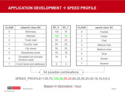

I attached an image that explains the mechanism behind the static speed values.
Each one of the 8 so-called NETWORK CLASSES is divided into 8 sub-categories labeled as SPEED CLASSES. So the complete set of street segments of a map can be cut into 64 independent sets.<br />Defining the MAX and MIN speed for 2 of the 8 speed classes enables us to interpolate the other 6 classes values.
So when our data department receives the raw data from the providers TOMTOM and HERE we map the input data into PTVs proprietary structure and during this process we determine the network and speed classes for all the segments. While some countries have low limits (such as France, limited to 130) others have higher speed classes (at least partial) such as Germany (STRIKE :lol: ).

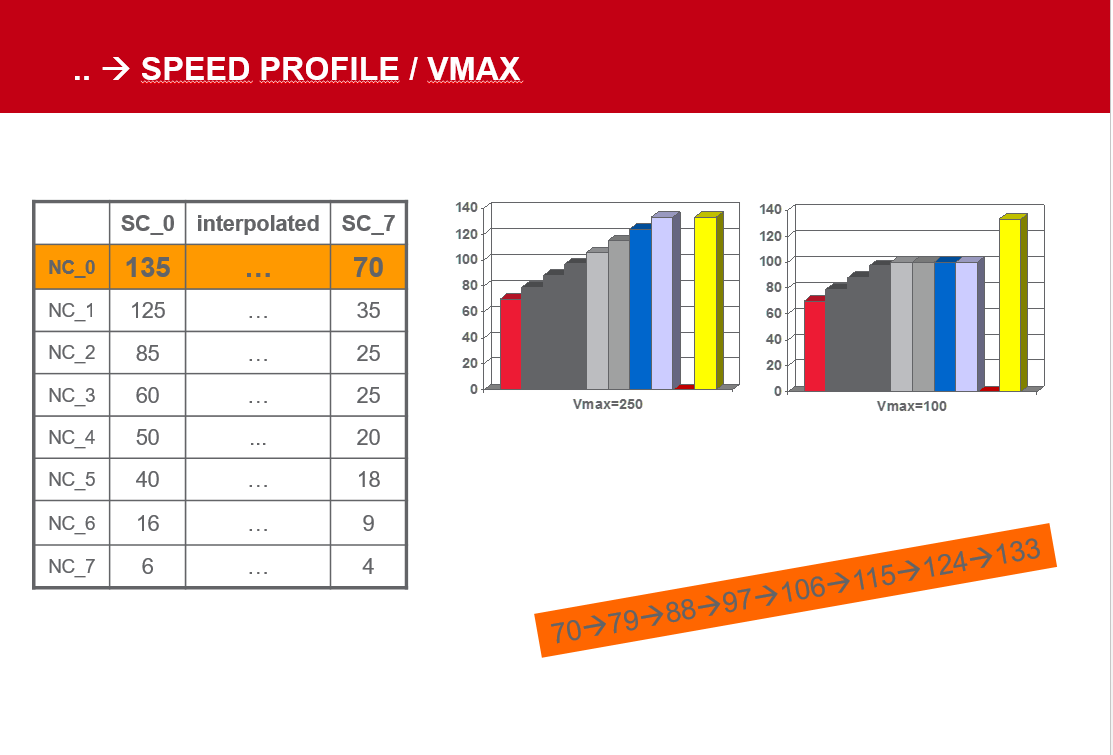

There you go!
Shows the interpolation

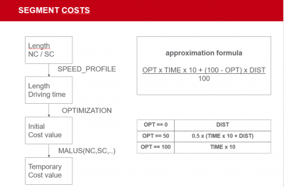

Shows the computation of travel time and virtual costs
After all this explains how we compute a best route: it is the path that produces the least amount of costs!
