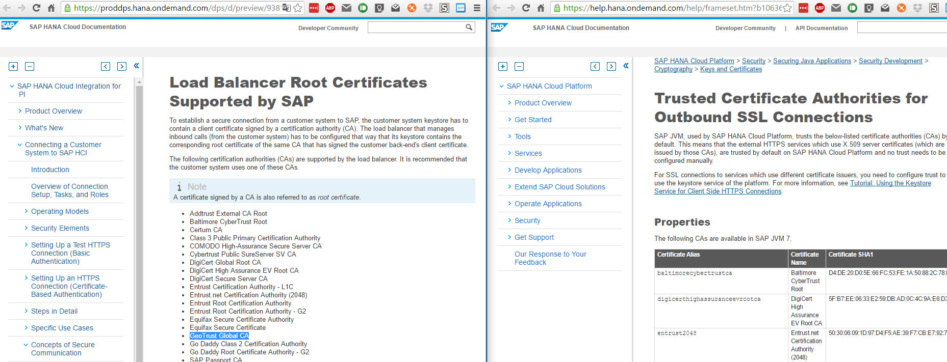

We use GeoTrust as Certificate Authority (CA) for the SSL access to our cloud services. GeoTrust is a large certificate providerthat is supported by all major browsers. Furthermore GeoTrust is supported by SAP , e.g. as Load Balancer Root Certificate.
https://proddps.hana.ondemand.com/dps/d ... 6cdea.html
But: GeoTrust is not part of the list of CA's for outbound SSL connections of SAP HANA JVM:
https://help.hana.ondemand.com/help/fra ... d4668.html
This prevents customers to connect from such a SAP HANA JVM to xServer INTERNET (or to any other HTTPS service that uses GeoTrust as CA). We are currently evaluating how to deal with this info - maybe there is a specific reason for this condition but we are not aware of the cause.

Meanwhile we have some new info: (Thanks Oli!)
Obviously it is possible to extend the keystore of a SAP HANA Cloud, looks like this is a new feature and so the workaround is no longer necessary:
For SSL connections to services which use different certificate issuers, you need to configure trust to use the keystore service of the platform. For more information, see Tutorial: Using the Keystore Service for Client Side HTTPS Connections.
Anyhow: we still wonder why GeoTrust is no longer part of the default...
