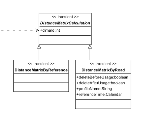

1. What is the structure of the distance matrix? Is it simply the diagram attached?
2. What’s the difference between DistanceMatrixByReference and ByRoad? “The distance calculated will be executed using the reference point method that means all distance approximated via reference points”? Where do these reference points come from?

- What is the structure of the distance matrix? Is it simply the diagram attached? - ANSWER: "yes. The BaseVehicle class contains a reference to a DimaID (optional). The concrete DistanceMatrices are defined in the planning parameters (as an array). Let's say your fleet is based on 3 vehicles: two trucks, one car. Then you need to provide two elements in the distance matrix array, e.g. {DimaID=1,profile=dimaTruck} and {DimaID=2, profile=dimaCar}. and the fleet is based on Vehicle#1{dimaID=1}, Vehicle#2{dimaID=1}, Vehicle#3{dimaID=2}.
- What’s the difference between DistanceMatrixByReference and ByRoad? “The distance calculated will be executed using the reference point method that means all distance approximated via reference points”? Where do these reference points come from? - ANSWER: the reference points come from previously generated operations, e.g. produced by a dummy planning considering all national postcode reference points (and without deleting the DIMA afterwards)
- What is a pre-calculated distance matrix and how does it get calculated? - ANSWER: see above, can be generated by a previous call or via xDima server
- Why is DistanceMatrixByReference empty? - ANSWER: the class DistanceMatrixByReference isn't emtpy, it's only property is the ID of the reference Dima that should be used...

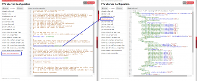

- Delete* parameters, where exactly is it deleting? Where are they stored? Is this relevant only when re-planning an already planned tour? - ANSWER: distance matrices are stored on the server below the /data/dima folder. Depending on your usecase it it meaningful to delete the DIMAs right after usage (e.g. because your customers change day-by-day) or to keep them (as a growing memory including static customer locations)
- Where are the ProfileNames defined? - ANSWER: check /conf and /conf/profiles.
