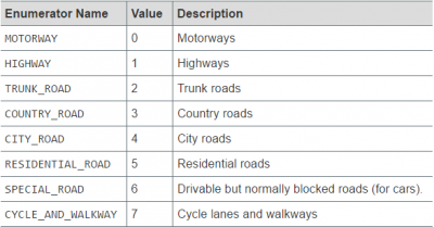

Hello Maik,
could you describe more detailed what the usecase rquirement is?
The data structure of the network classes itself is quite simple: just 8 categories.
- http://xserver.ptvgroup.com/fileadmin/files/PTV-COMPONENTS/DeveloperZone/Documents/xServer_public/manual_1.22/Default.htm#API-Documentation/xroute/API_Documentation.html#com.ptvag.xserver.xroute.NetworkClass%3FTocPath%3DDeveloper's%2520Guide%7CAPI%2520Documentation%7CAPI%2520Documentation%2520PTV%2520xRoute%7CComponent%2520xroute%7CEnumerations%7C_____14

Visual respresentation of networkclasses arround Sydney:
- Red: NC0 , Motorways , often als called something like ... motorway or M<number>. You find these only around the major cities
- Orange: NC1, Highways, often als called something like ... Highway. These are the major interconnecting roads all over Australia. Keep in mind though that in more rural area the highway can go straight threw a village with a local speed limit without changing the road type.
- Yellow: NC2, trunk road, often they are also called something like ... Highway but usually are a bit smaller then the NC1 highways.
- Green / Brownish: NC3, Country roads , often they are also called something like ... Road. Keep in mind that roads are a more general term also use for lower classes. Used for some major connecting roads in cities and the non-highway connecting roads in rural area's.
Not shown in this example are NC4, major non-connecting city road and NC5 residential road. NC6 and NC7 are usually roads where vehicles are not allowed on.
I hope this helps.

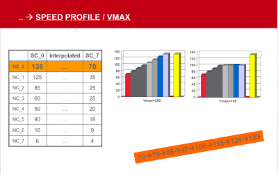

Re: street category mapping Australia
Posted: Thu Aug 11, 2016 1:18 pm
Hello guys,
@Joost: thanks for the attache image!

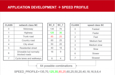

And for Mike: as Joost and I described there are 8 NETWORK classes that are furthermore separated into 8 SPEEDCLASSES from
- incredibly fast
- fast
- bit faster than average
- bit slowlier than average
- slow
- incredibly slow
- Profile speed values

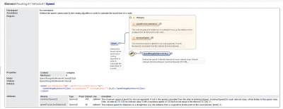

You can then use those values, e.g. like here:
<Speed speedForAirLineDistance="36">
<SpeedRangeByNetworkClass minimumSpeed="70" maximumSpeed="135" />
<SpeedRangeByNetworkClass minimumSpeed="35" maximumSpeed="125" />
<SpeedRangeByNetworkClass minimumSpeed="25" maximumSpeed="85" />
<SpeedRangeByNetworkClass minimumSpeed="25" maximumSpeed="60" />
<SpeedRangeByNetworkClass minimumSpeed="20" maximumSpeed="50" />
<SpeedRangeByNetworkClass minimumSpeed="18" maximumSpeed="40" />
<SpeedRangeByNetworkClass minimumSpeed="9" maximumSpeed="16" />
<SpeedRangeByNetworkClass minimumSpeed="4" maximumSpeed="6" />
</Speed>
This means 70km/hour on the "incredibly slow" SPEEDCLASS on NETWORK CLASS0 and 135KM/hour on the "incredibly fast" SPEEDCLASS and so on.
- speedclasses within network classes
- Interpolated
