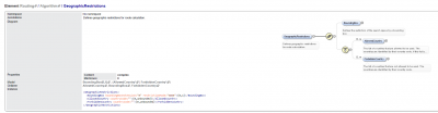

sounds like you could benefit from our Geographic Restrictions:
http://xserver.ptvgroup.com/fileadmin/f ... strictions
- Shows tha positive / negative lists.
As xTour requires setting such properties in the profiles on server side you can easily create lists of allowed or forbidden country (only one of them by the time).

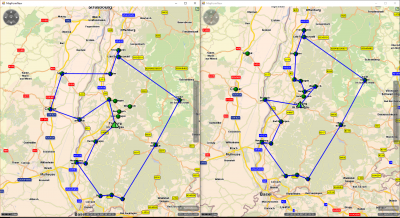

- Left map: though the dima is based on "Germany only" the tours consider locations in France (west of Rhine). This is because the distances and routing times are estimated based on the FallBack mechanism.
Right map: The dima is based on "Germany only" and the fallback is disabled. Therefore French locations remain unscheduled.
