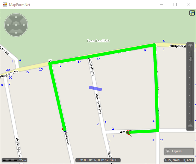

Also in my opinion exception path is the only possibility to block individual segments within the request. I do not recommend to use the attribute "street". I think this is designed for motorways like "A5" and not for all "Schillerstr." in Germany, but here I'm not sure how it really works. Why not using our new feature "intersectingLine"? Just specify the street by two coordinates crossing the street (see sample "Routing with an intersecting line").
As exception path is an array it is possible to specify more than one street. But be careful: A lot of exception paths in every routing request have an impact on performance.
I created a quick sample:
The blue line is given as ExceptionPath and crossing the line is forbidden. This causes the router to perform a detour.
