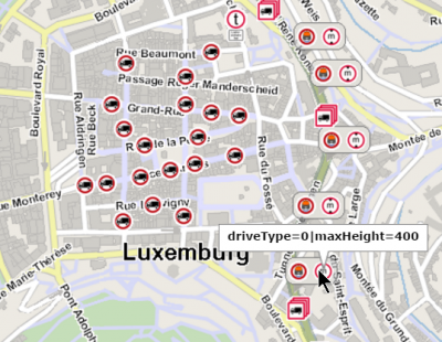

When Truck Attributes layer is displayed on Ajax Maps, it shows generic icons for truck restrictions, same for each type of restriction (e.g. two different weight limits will be displayed with same icon). Is it possible to get and display detailed information, for each restriction? (e.g. that one weight limit is 2tons and second 7 tons)

Hello Krzysztof,
are you using this sample from the tutorial ?
(on premise link - please adapt the IP)
http://127.0.0.1:50010/ajaxmaps/tutoria ... e%20Layers
- FeatureLayer based example of truck attributes.
TThe tooltip demonstrates the access to the segment properties.

After some investigation, I found out that the lack of tooltips was caused by error in my onMouseMove event handler for vector layer. The handler did not have a return statement. After adding return false (true also works), tooltips appeared on the map.
