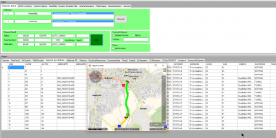

how about using the following ROUTING OPTIONS
RoutingOptions<br />ALLOW_SEGMENT_VIOLATIONS = true<br />COST_OF_SEGMENTVIOLATIONS = 0
RoutingOptions
2016-06-03 18_20_00-96,2059.png (1.83 KiB) Viewed 12090 times
This will ignore the cause for the error and inform you in the response segments based on VIOLATIONS:
Violations of truck attributes are ignored but reported in the response.
