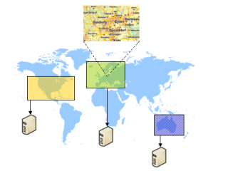

Hello Sebastian,
first of all: unfortunately combining the individual map folders in one common folder doesn't work like that.
From a server administrator's perspective: You have to setup two server instances if you want to use 2 different maps. If both server instances are running on one shared machine you need to reconfigure the ports of one of the instances.
Sample architecture
Sample architecture
From a client developer's perspective: If you want to use both services (mapping server Europe + mapping server SouthAmerica) you have to access the two separated service urls within your application and decide "which one is needed right now.
Another approach of the topic is to use the WORLD map provided by PTV (though I'm not sure about the licensing model behind that major map).
Let us know if you need further hints.
PS: there is also a small chapter available dealing with this topic: http://xserver.ptvgroup.com/fileadmin/f ... s%7C_____1

Thanks for the info Bernd. Will take care about the steps to get an additional instance running.

Post by Howard »
Thanks for the clarrification.
I used the chapter "Changing Default Ports" from here to create two Instances for each xServer with the two maps.
I found that two additional changes were necessary for our environment:
1) For each xServer: Change the variables "wrapper.name" and "wrapper.displayname" in the conf/wrapper.conf file to reflect the map name. (Otherwise you have a problem with the Services.)
2) For the XRouteServer with ContentUpdate enabled: Change the file conf/content-update.properties and change the notifyServers variables (and the map directory if it's used).
Thanks for the help!
