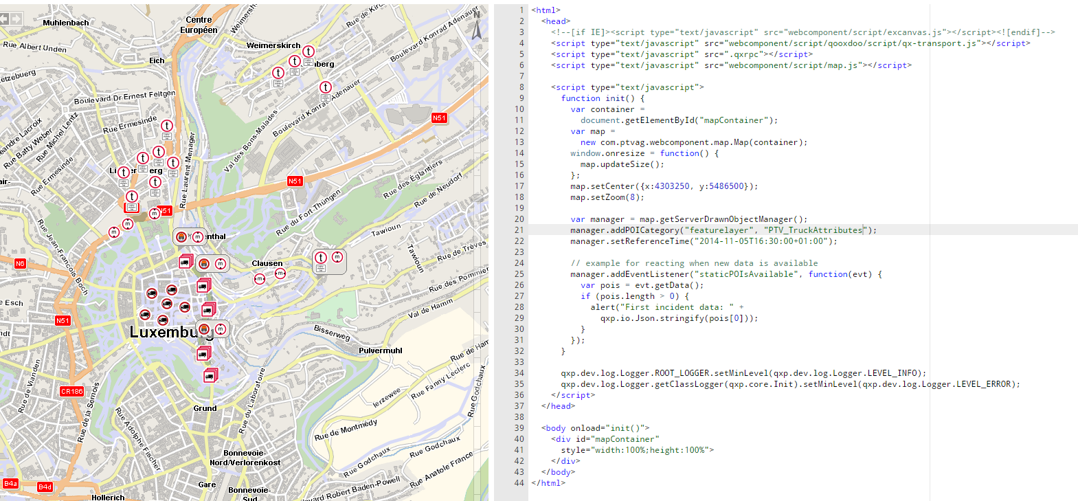

I would like to display PTV_TruckAttributes feature layer using Ajax maps but I cannot find the information how to do it. The code browser sample uses LeafLet maps and I am unable to convert it to Ajax maps.

it should work like this:
var manager = map.getServerDrawnObjectManager();
manager.addPOICategory("featurelayer", "PTV_TruckAttributes");
"featurelayer" is a predefined data provider in AjaxMaps.
Andreas

Yes, it works. Thank you for your help.

Screenshot of feature layer sample displaying the TruckAttributes within AJAX maps.
