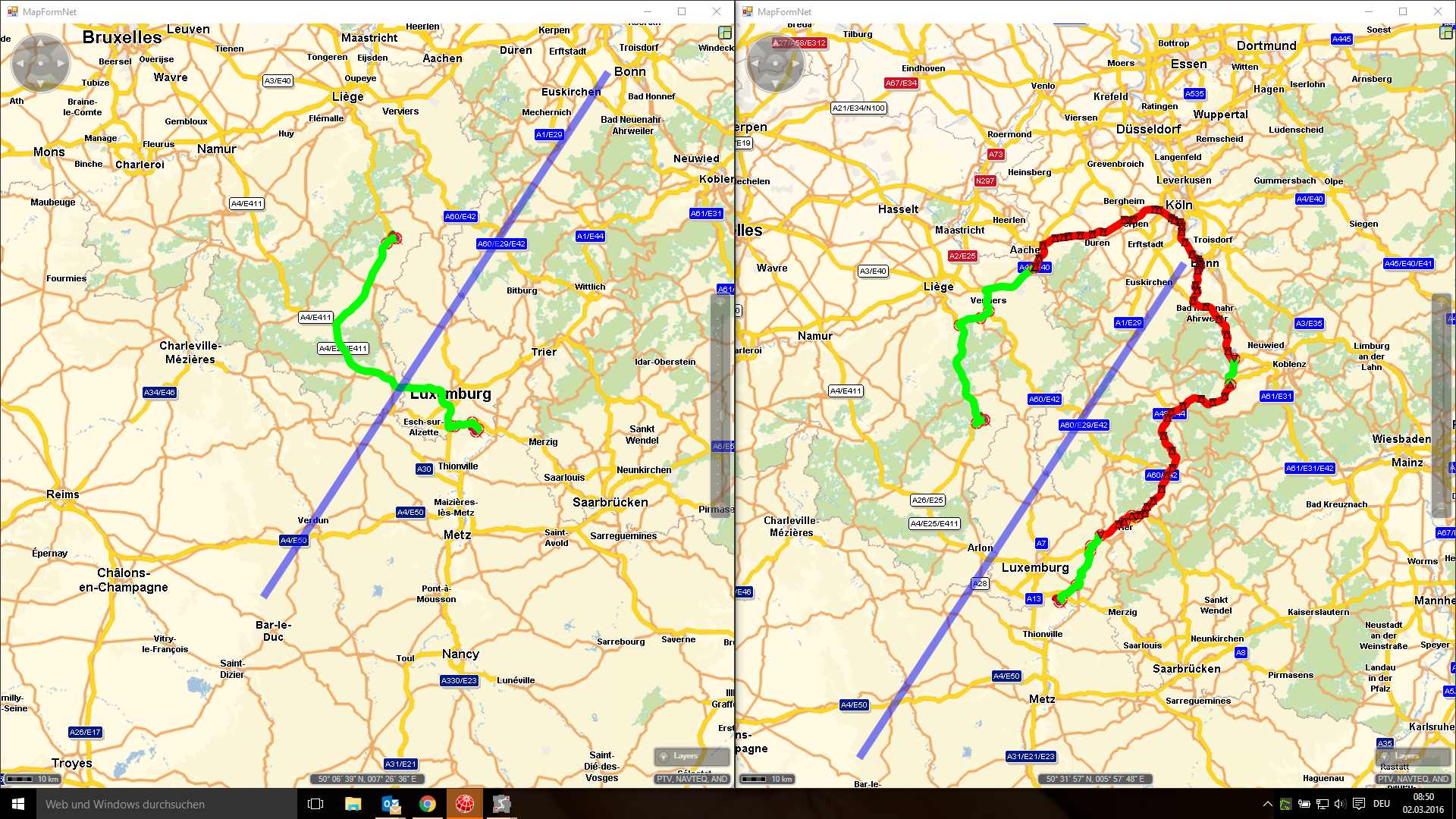

we are about to release the 1.22 servers and I already made some enhancements in my WKTC (=Welter known Test Clients) such as xRouteToll. Here is just a screenshot of one of those features: it is a new option of how to define blockings of streets with an Exception Path: it is called an intersectingLine:
intersectingLine LineString
A representation of a route path containing all segments that are crossed by the given intersecting line which is represented by exactly two points (optional)
Image on the left shows the standard route which is not taking care of the intersecting line. The picture on the right is based on a 2501-malus being applied to the line.

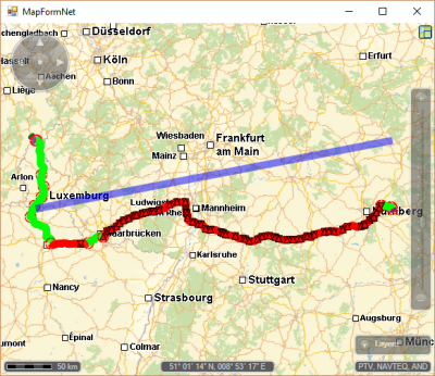

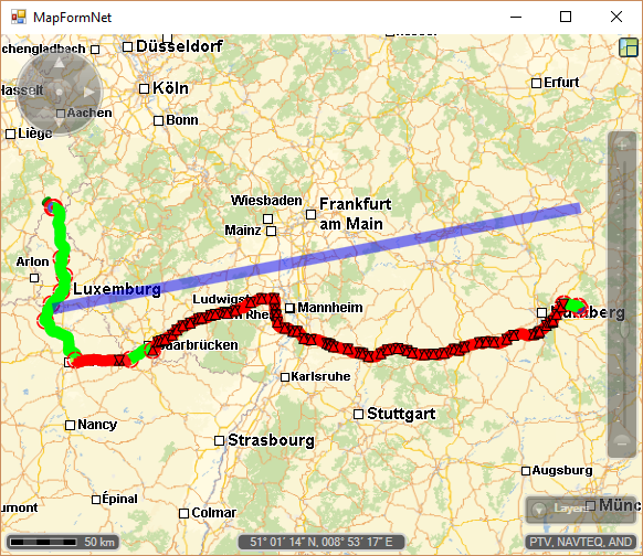

The routing polygon performs a detour around the critical line.
