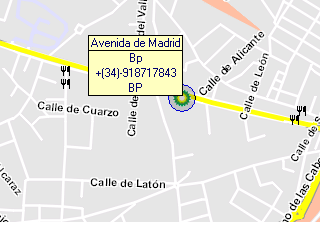

To get information from a poi at a specific coordinate, we are using the function GetPoByLocation(PoiLocation, null, null, [ResultField.POPUPINFO, ResultField.PHONENUMBER, ResultField.PHONENUMBER,ResultField.POINAME, XLocateService.ResultField.POITYPE], caller).
The PoiAddressResponse has a list of poiResultAdress, but for each poiResultAddress its property wrappedAdditionalFields is empty for each resultField value.
Is it posible obtain more detailed information for a poi in a specific location? (ie. Telephone number)
NOTE: When we used the old map control (Map&Guide versión 5) this control automatically show tooltips with information POI more detailed and also the icon of poi is more representative. (see attach)
Thanks.
Poi whith Map&Guide versión 5

are you using xServer-internet or your dedicated xServer? If you have your on-premise xServer you can change the POI-profiles to return addtional fields for xLoacte and xMap.
