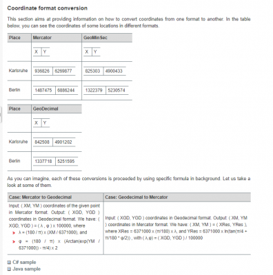

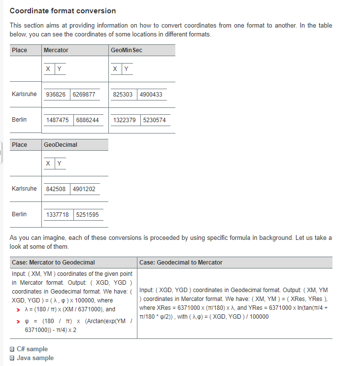

By the way: there's also a description of how to transform coordinates from MERCATOR to OG_GEODECIMAL and vice versa:
Feel free to use these terms to transform coordinates on client side.
