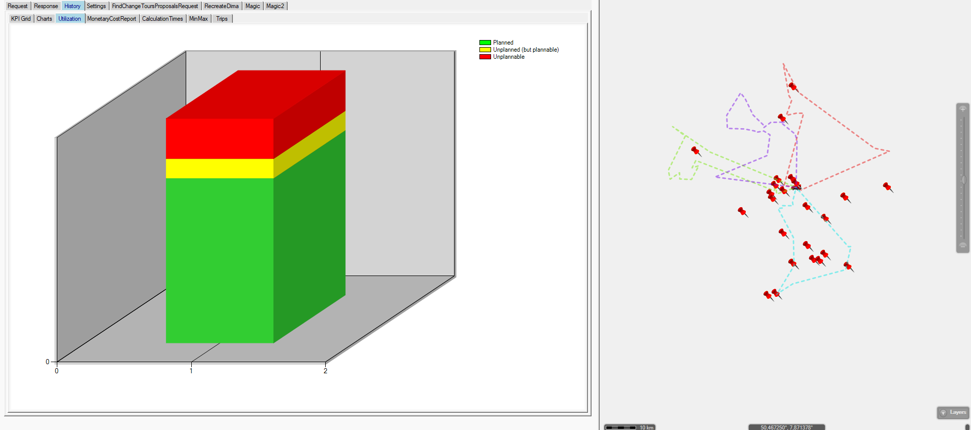

one of my partners does a tour planning with xTour2. I usually qualify each input order based on the response:
  • RED : order is not planable at all - e.g. due to "no verhicle has sufficient capacity" or "no vehicle available on the order's locations opening hours". So the order's ID appears in the ToursResponse.orderIdsNotPlannable array.
  • YELLOW : order appears in orderIdsNotPlanned but does not appear in the orderIdsNotPlannable array. Congratulations: the order has been sacrificed for the benefit of other orders. Add more resources to cope with the workload.
  • GREEN: order is planned on one of the output tours.
Now the question that has been raised recently:
What if I ommit the RED orders from the input workload?
  • Would this speed up the calcutation for the final result? (no timeout applies)
  • What is the impact on the quality of the result?
  • Does the engine identify the RED ones first and then process only the "not RED" ones without any difference?
What generic answers can we give to the player?
Bonus: Unscheduled Order Analysis
Longstory short: you can apply a more or less simple business logic to get more info about why a specific order is seen as yellow or red. Based on stored request ID.
  • RED: Try to assemble a simple vehicleStart-Order-vehicleEnd tour for each vehicle and use the returned violations to get the causes.
  • YELLOW: Try to place the specific order in each vehicle's input tour on each potential insertion position and check, what violations raise.
example from my user: about 20% of the workload is RED.
