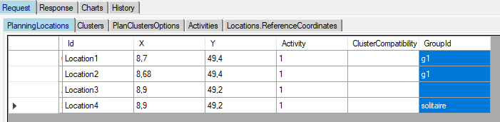

Check the column &quot;GroupId&quot;: <br />Location 3 is not critical : it does not specify a group ID.<br />Location 4 raises the error: it is an isolated group ID
Check the column "GroupId":
  • Reason: This error occurs, if you perform a pregrouping and one of your preassigned groups contains only a single element.
  • Solution: In this case remove the GROUP property from all locations which belong to a single element group.
