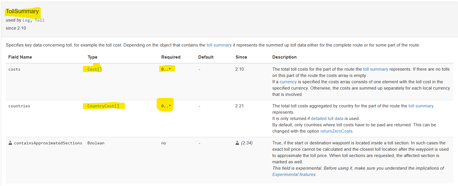

one of our users just mentioned this effect I wasn't aware of. Could DEV please comment on this? Is this a bug?
The user works with xRoute2 and calculates toll. In the response he deals with the com.ptvgroup.xserver.xroute.TollSummary which is documented to return an array called costs with a length of 0 or more
Now under certain plausible conditions there might be no contribution of toll in any of the used countries and he would expect some
"toll":
   "summary":
      "costs":[],
      "countries":[]
Instead he get's
"toll":
    "summary": {}
So neither "costs" nor "countries" appears at all.
Is this a bug? Philosophy? Art?
I think we use "0+ length" arrays at various elements - is this something we should change / handle in a different way?

This behaviour is in fact documented in the technical concept on requests and responses under the paragraph "Response structure":
Noteworthy about result lists: Empty result lists are omitted from the response. Depending on the used client technology you might have to check if a list exists before iterating over it.
