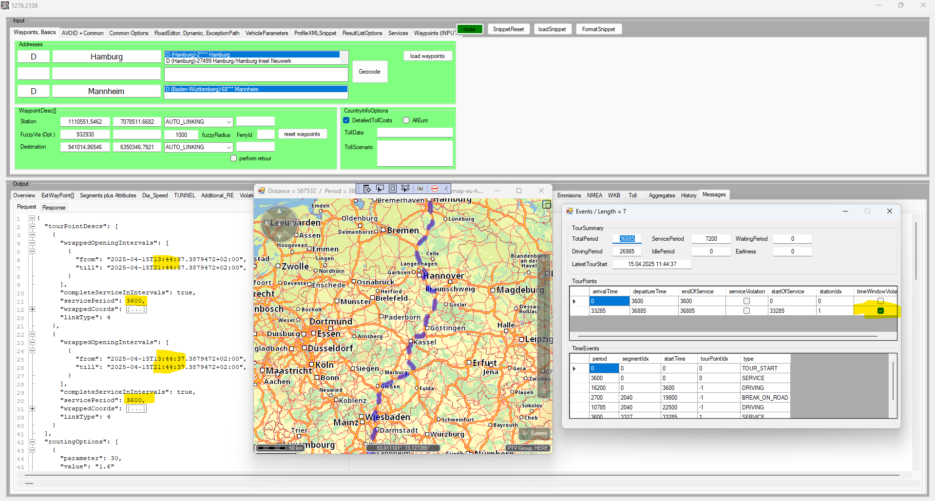

But I made at least some experiment with my existing textclient:
  • Route from Hamburg to Mannheim: net driving time is about 10 hours
  • Both TourPointDesc operating intervals are 8 hours, service period is 1 hour
  • Obvious violation at the 2nd waypoint is reported.
Maybe we have to include some xRoute1 expert? And of course the colleague who asked the question (I am just the proxy) ;-) ...
