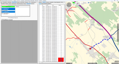

which specific restriction does the vehicle currently violate when it tries to enter the city? Did you already avaluate the various vehicle properties we offer in the Routing API?
As you can see in the screenshot: some of the restrictions apply for named cities.
Is the city "top secret" or can we share this scenario and even the routing request in public? If not please create a helpdesk ticket and we will try to reproduce your story together with you.

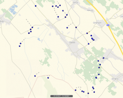

Here is the polygon of DABAS:

Your selected segments around the city
From what I see in the first reponse the segments inside Dabas are partially restricted to "delivery" which cause violations.
Routiug successful though violated

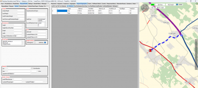

Well, this is what immediately caught my eyes:
  • "distanceTimeWeighting": 100 - causes the engine to look for a very FAST route, even if a detour applies. Probably you should use values between 20 and 80.
  • Code: Select all
    "isDelivery": false
    - means you are not allowed to use "deliveryOnly" segments. Set this value to true and...

    - the "2" means that outside an area of 2km around any involved waypoint we do not "see" those network classes 5,6,7 but some roads in Dabas are NC 5.
Long story short - there's not just a single parameter that has a relevant impact in this story - you need to discuss a proper combination!
