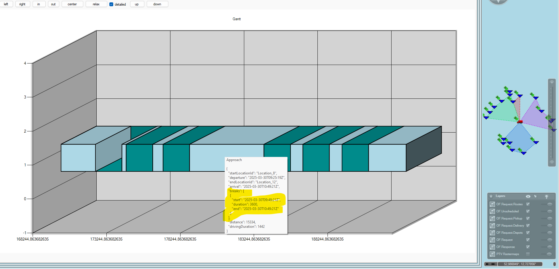

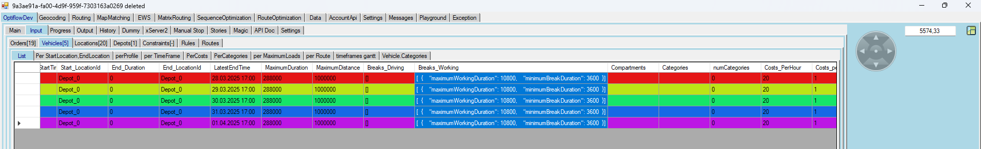

Here's some visual feedback:
xTour1 WorkingRule
xTour1 WorkingRule
Example built with xTour1
Example built with Developer Route Optimization OPTIFLOW: input vehicle definition
Example built with Developer Route Optimization OPTIFLOW: Result
