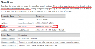

the sorting order is preconfigured in the server side profile but you can override it via the optional parameters of the method.
See attached screenshot!
![findAddress.png (40.96 KiB) Viewed 9291 times view into the API doc of xLocate.findAddress](./download/file.php?id=204&t=1&sid=7f32d9ac8e8df7b1b775d6ae2ea40b58)
- view into the API doc of xLocate.findAddress

Well, sounds like a different question...
As long as the server uses same map data (same provider, same annual version) and configuration the same input should generate the same output.
The default sorting order as it is part of native-default.xml is
<SortingOrder SortFieldsNumber="17">
<Field0 FieldName="Score.TotalScore" Ascending="false"/>
<Field1 FieldName="AddressClassification" Ascending="false"/>
<Field2 FieldName="PostalCode.Classification" Ascending="false"/>
<Field3 FieldName="Street.Classification" Ascending="false"/>
<Field4 FieldName="Town.Classification" Ascending="false"/>
<Field5 FieldName="IsCityDistrict" Ascending="true"/>
<Field6 FieldName="HouseNr.Classification" Ascending="false"/>
<Field7 FieldName="Population" Ascending="false"/>
<Field8 FieldName="Country" Ascending="true"/>
<Field9 FieldName="City" Ascending="true"/>
<Field10 FieldName="City2" Ascending="true"/>
<Field11 FieldName="PostalCode" Ascending="true"/>
<Field12 FieldName="Street" Ascending="true"/>
<Field13 FieldName="HouseNr" Ascending="true"/>
<Field14 FieldName="CombinedTransport.Name" Ascending="true"/>
<Field15 FieldName="CombinedTransport.Start.Name" Ascending="true"/>
<Field16 FieldName="CombinedTransport.Destination.Name" Ascending="true"/>
</SortingOrder>
So from my point of view this should be "deterministic" if you don't change the sorting order within the request and you apply equal search options.
Is this sufficient?
