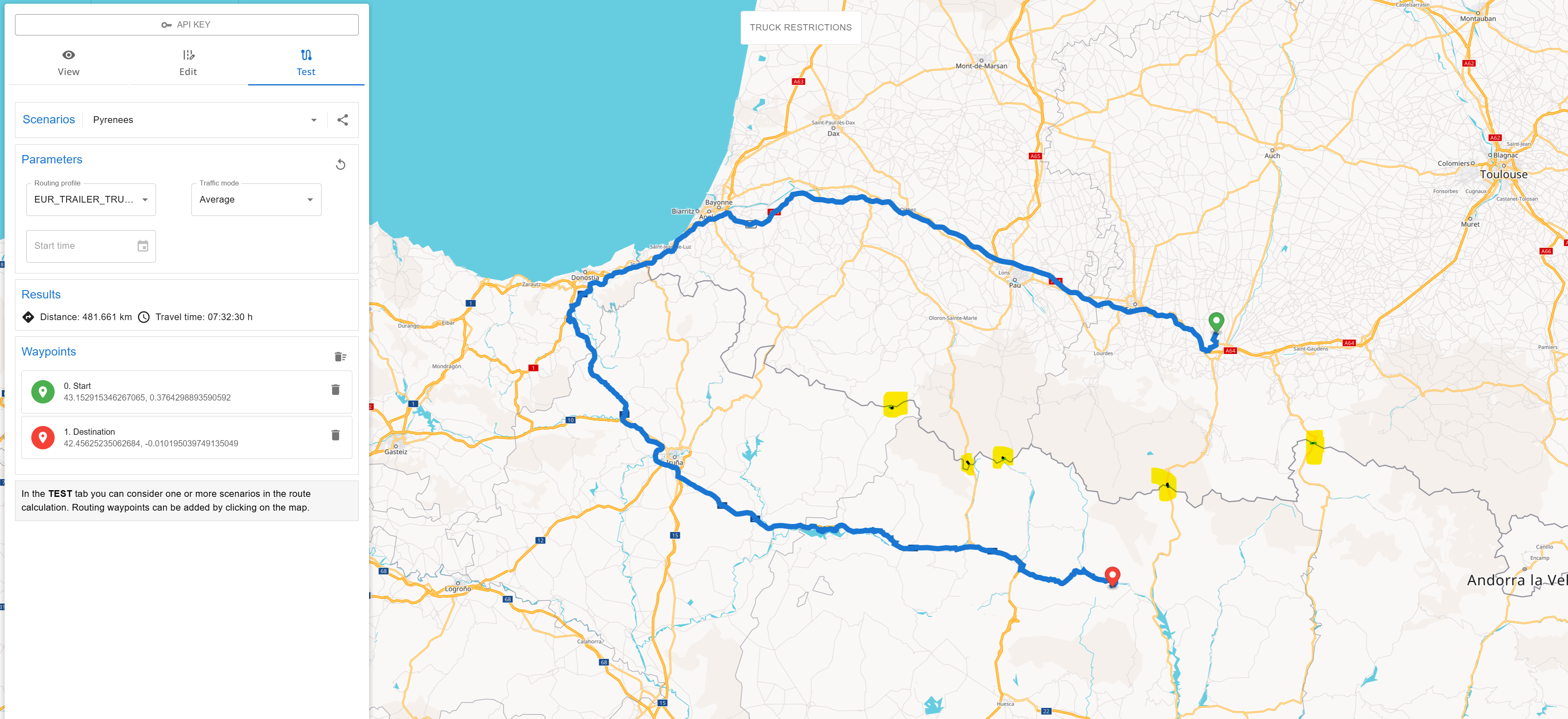

I used the showcase:CustomRoadAttributeScenarios to block several major, improper roads in the Pyrenees.
The routing then performs the expected detours.

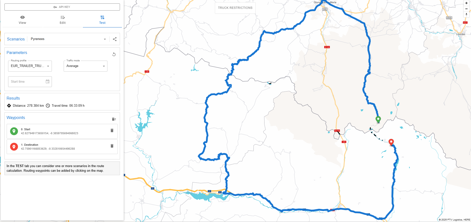

Here's an addendum to the approach with the segment blockings:

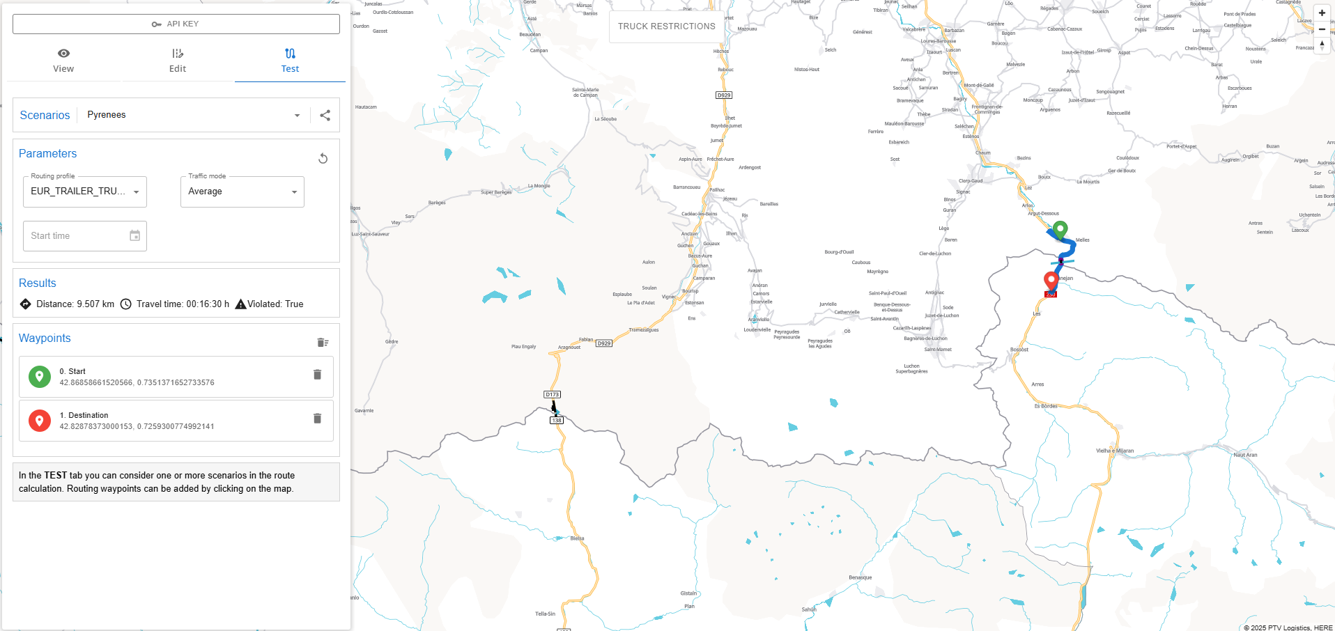

  • The costs for violations apply for each contiguous group of segments. This usually works great in small, local areas. But with major areas such as alps or pyrenees with a sparse routing network the detours to adjacent valleys are so expensive that violations are tolerated.
  • Therefore it makes sense to create groups of unconnected segment blockings which will cause the violated transit to be too expensive compared to the detour.
If a detour around a single segment is way more expensive than a single violation the routing stays on the violated pass. Furthermore in this example also the nearest alternative pass would cause violation costs.
several non-connected segments are blocked. Violating them for a transit would cause massive additional costs for the aggregated violations. Therefore a detour applies.
