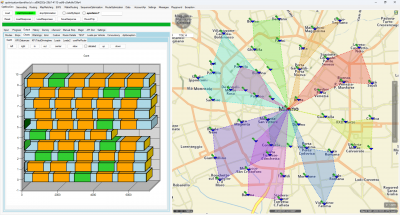

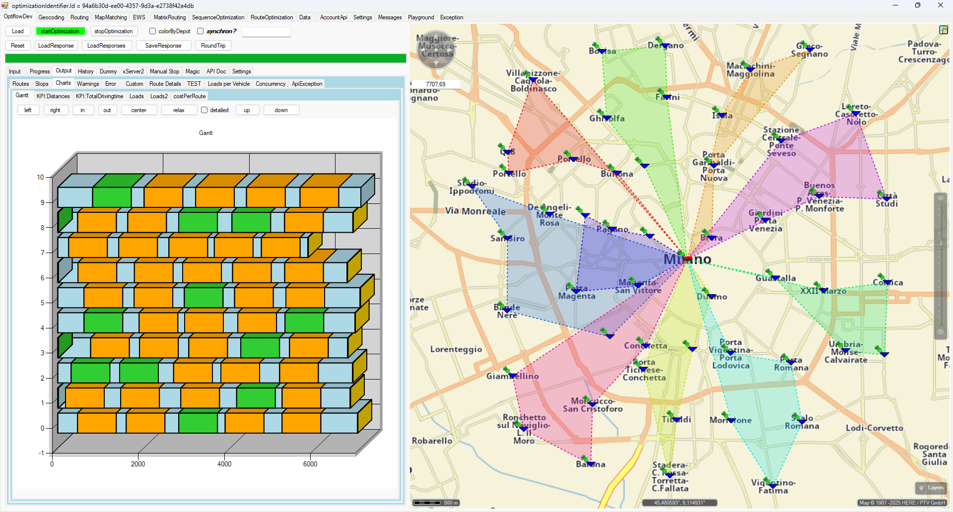

  • I start with a maximum route duration of 150 minutes...
    With a max tour period of 150 minutes only a fraction of the fleet is utilized: 7 trucks.

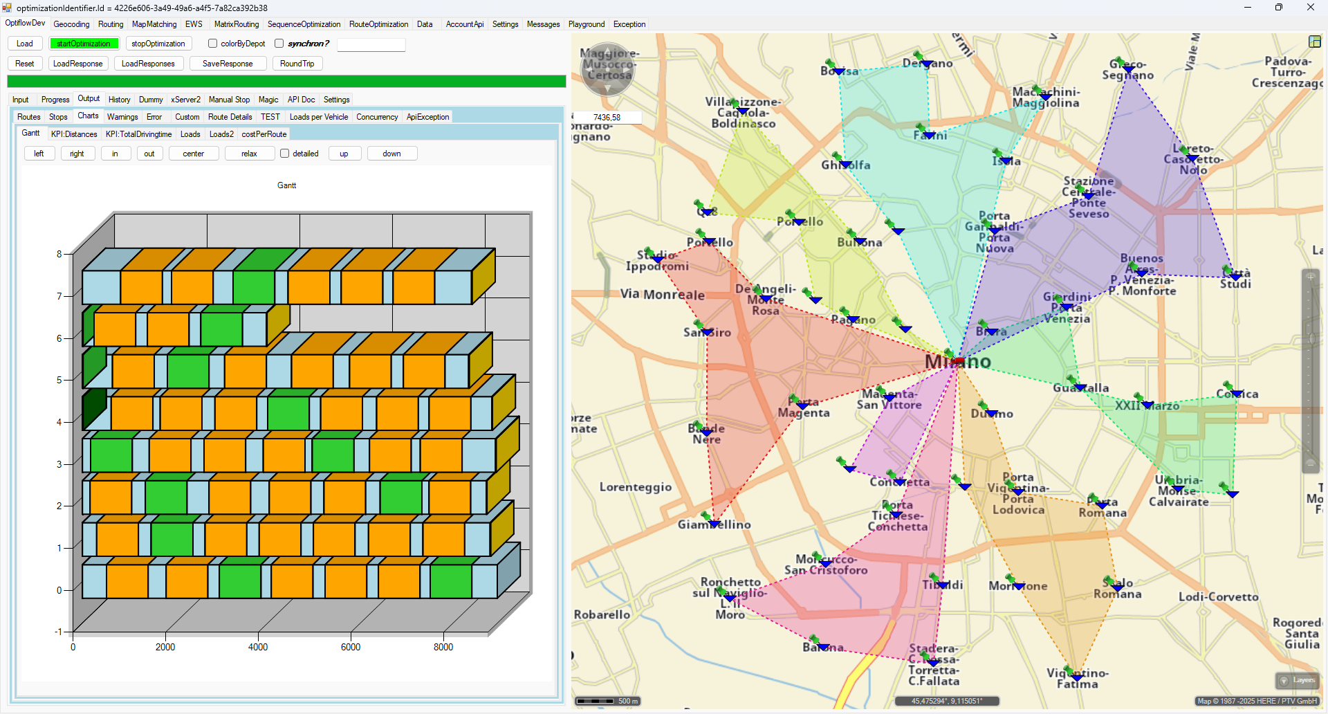

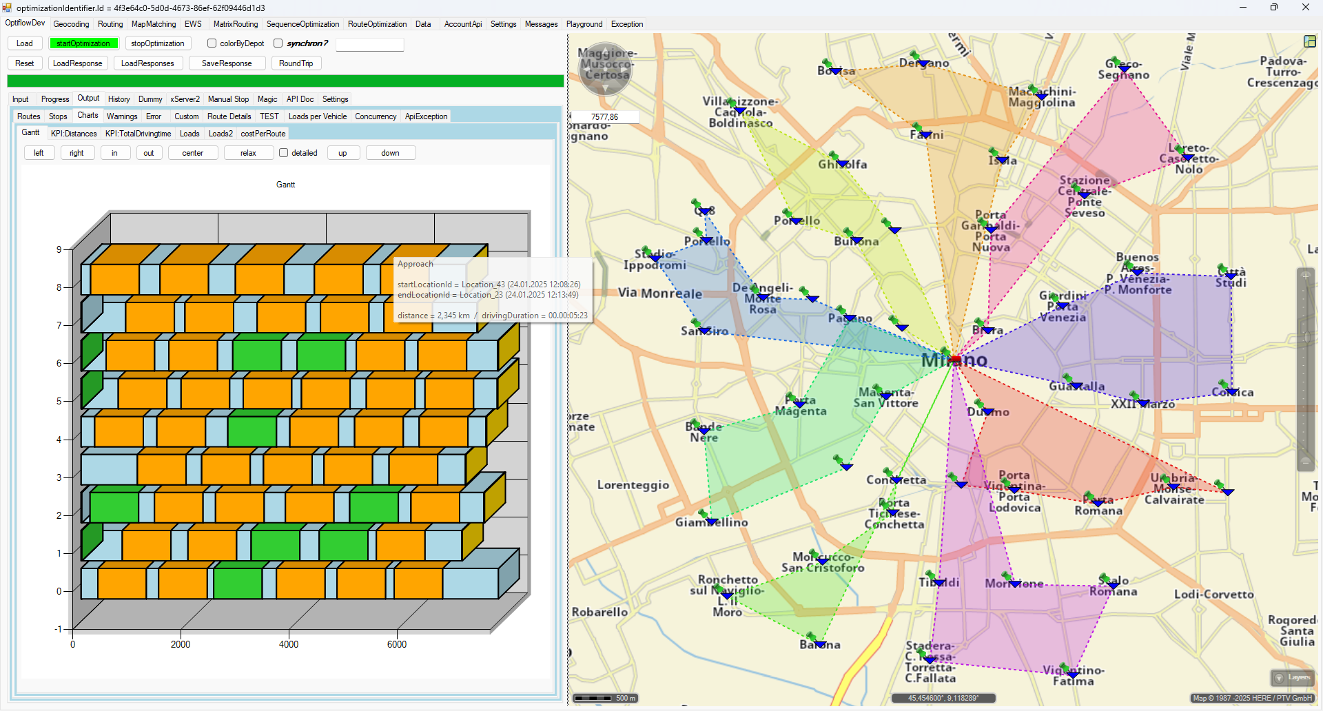

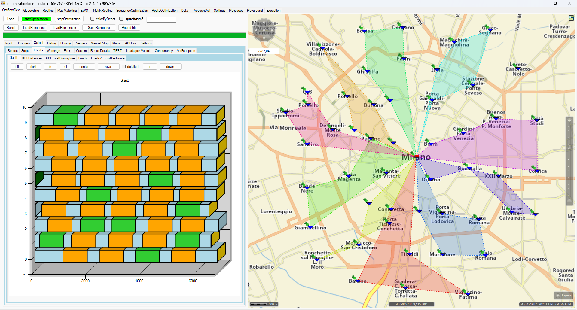

  • With 140min I already need 8 vehicles, so I decide to reduce again
  • 130min : reduce again
  • 120min : reduce again

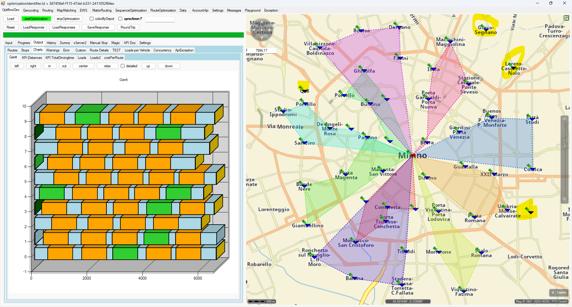

  • 100min : though the utilization of the vehicles seems to be balanced this threshold causes unscheduled orders: Rule 1 applies! RELAX
  • 112min : still unscheduled orders: Rule 1 : RELAX

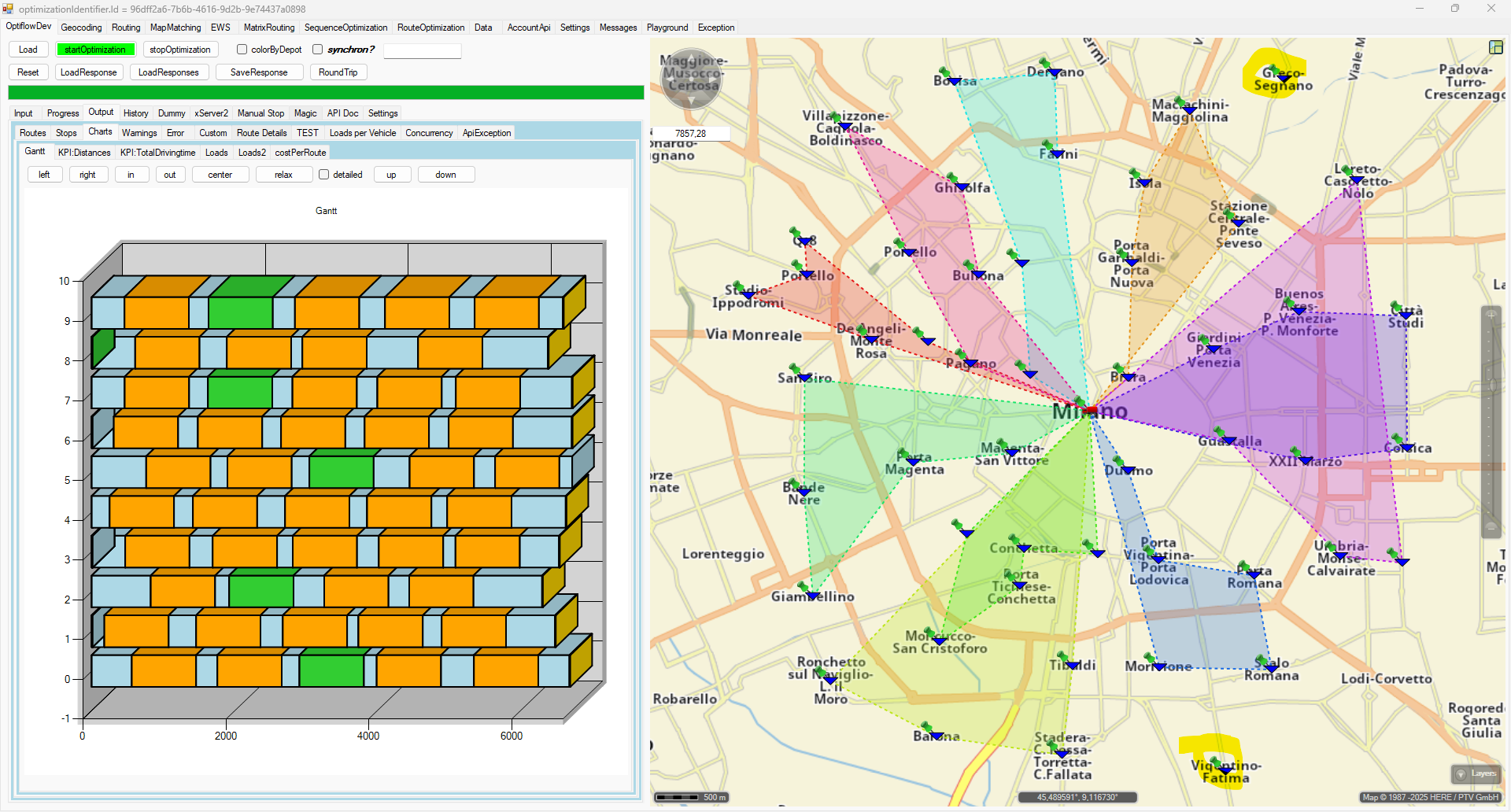

  • 114mins - still 1 unscheduled order

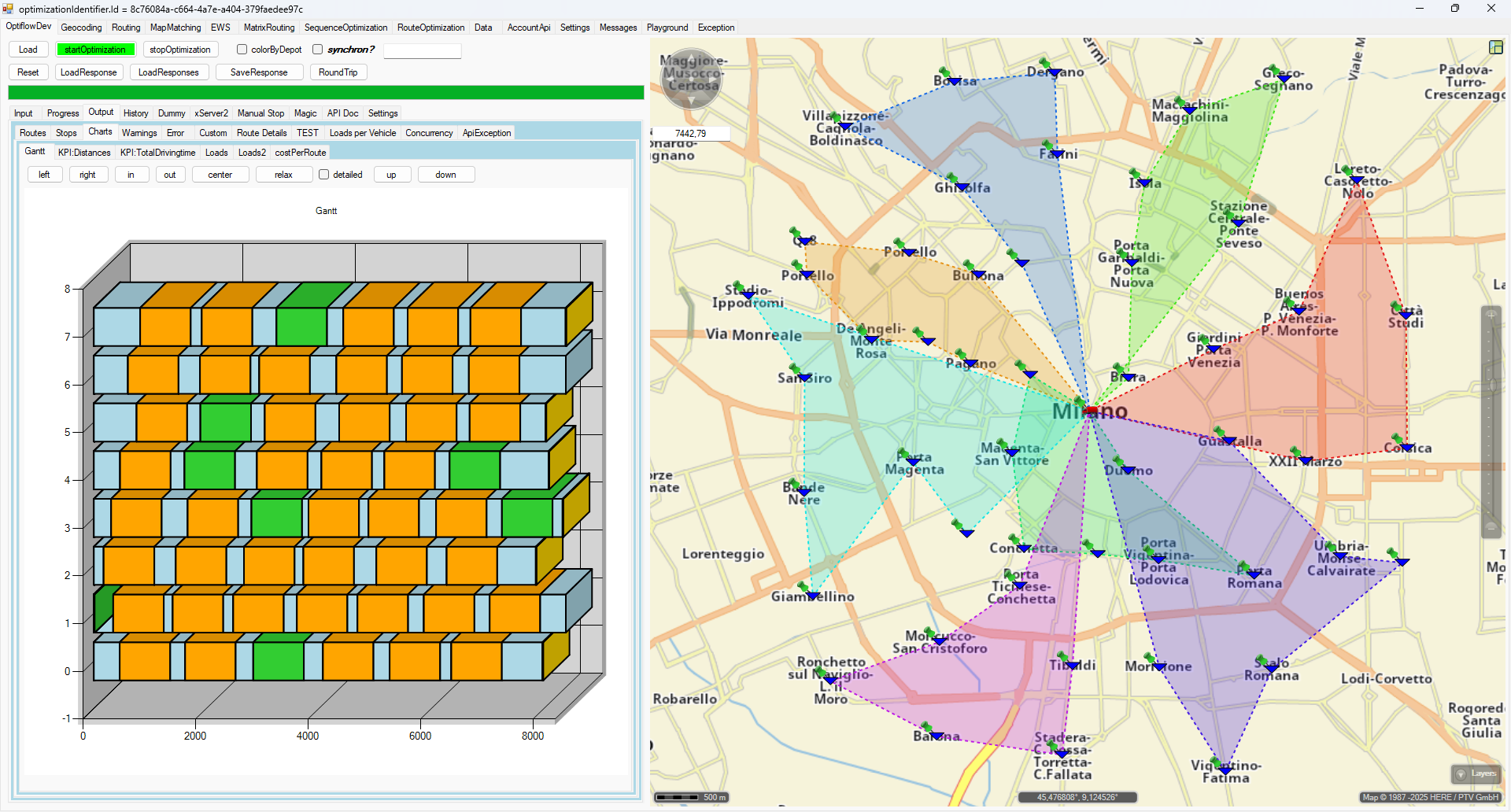

  • 118 - all scheduled... Rule 2... and so on

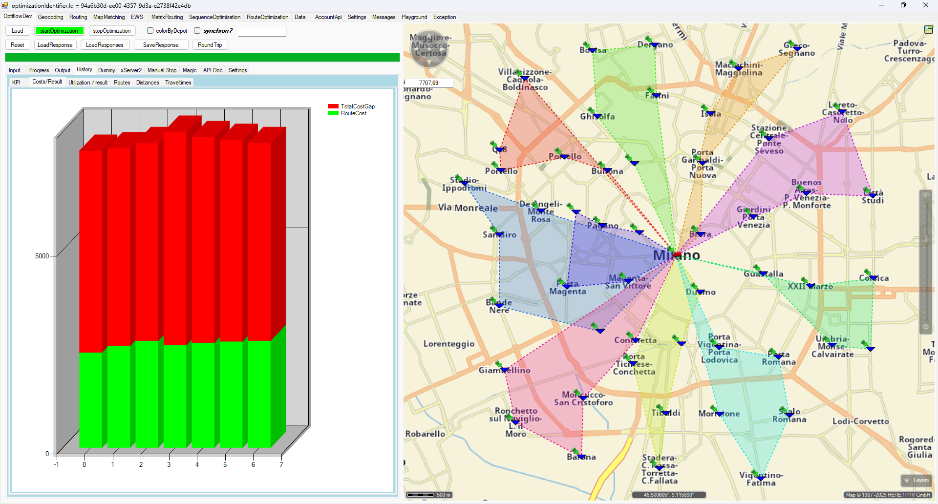

    • This chart shows the impact on the costs: reducing the threshold pushes towards higher costs. Relaxing reduces costs (at the end). The cheapest solution ever was the one when balancing was completely irrelevant.

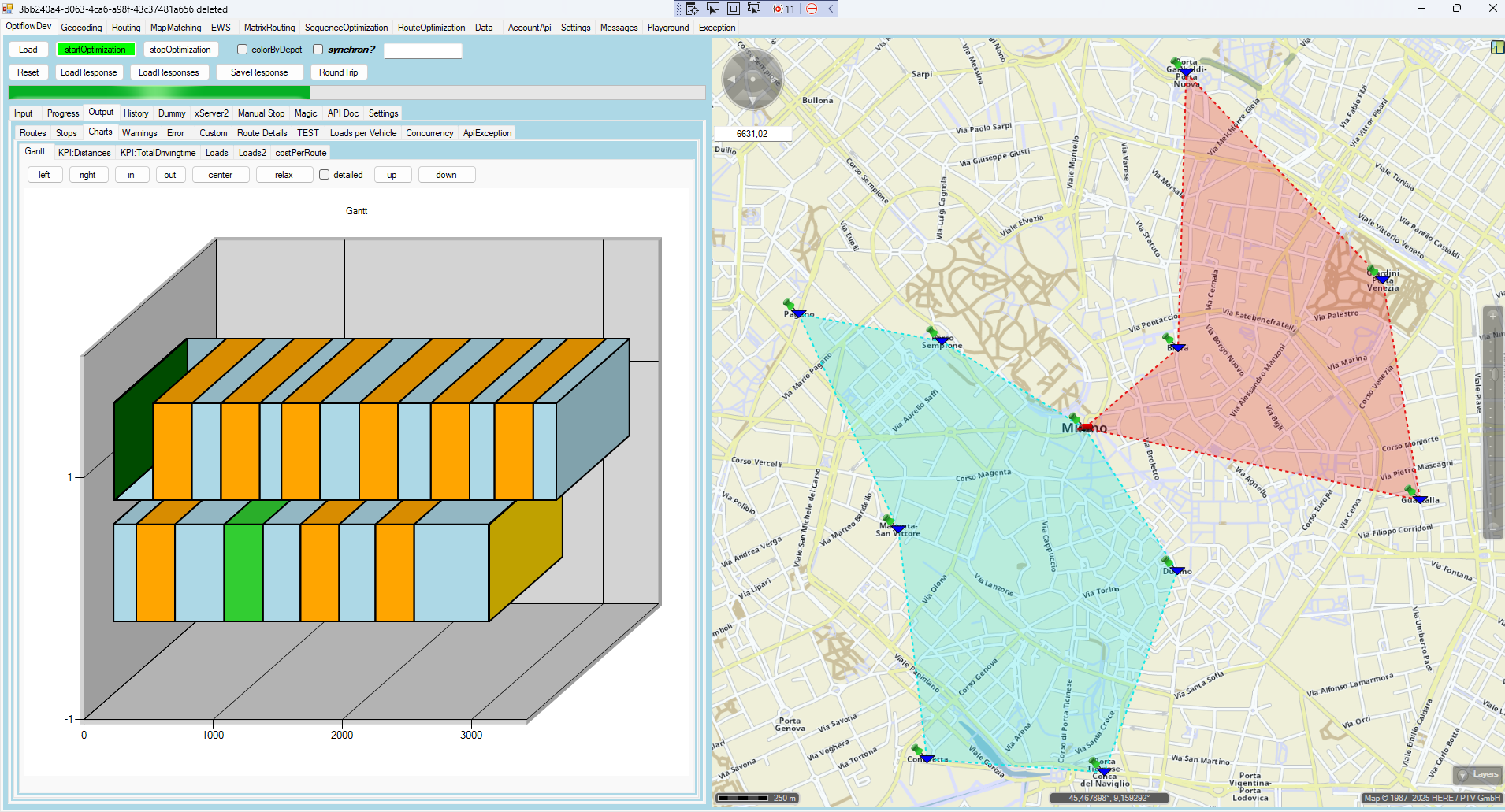

Just discussed this with the colleagues from the engine team and competence center. Their recommended strategy is was more simple to implement:
  • Ensure to have the vehicle fix costs set to 0.0 - this ensures that utilizing all vehicles is not a conflict.
  • Set the regular vehicle working costs and distance costs to compareably cheap set for an acceptable "minimum tour length" and add significant overtime costs for the rest.
  • Example: 5 vehicles - 9:00-17:00...:
    • Vehicle.Costs.perHour = 2'000
    • Vehicle.Costs.perKilometer = 100
    • Vehicle.Costs.Overtimes.Threshold = 3600
    • Vehicle.Costs.Overtimes.extraPerHour = 10'000
    "costs": {
            "perHour": 2000.0,
            "perKilometer": 100.0,
            "overtimes": [
                "threshold": 3600,
                "extraPerHour": 10000.0

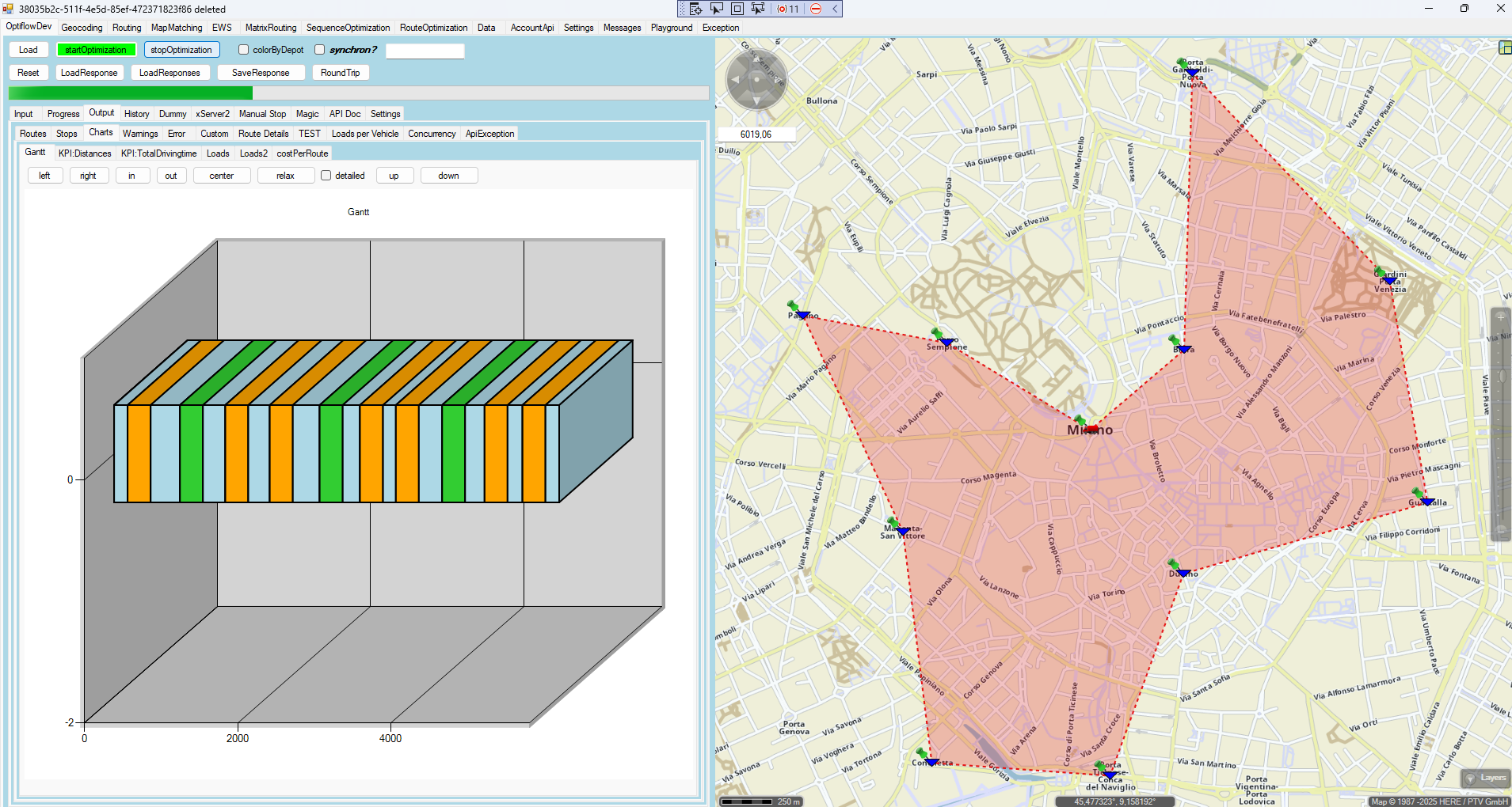

    One vehicle does the workload...
    But two are balanced...
