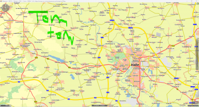

Map 2024.1T (Tomtom) - https://xmap-eu-n.cloud.ptvgroup.com (captured on 16.10.2024)

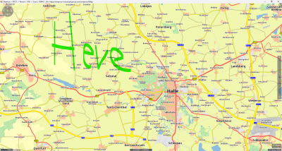

Map 2024.2H (HERE) - https://xmap-eu-h.cloud.ptvgroup.com (captured on 16.10.2024)
Though the road is displayed it's section North of the exit Halle Süd is not used in trouting. Honestly this looks confusing at the first glance.The road is not even displayed.

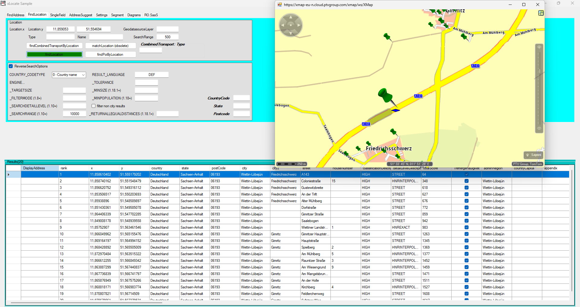

The following screenshots are based on xLocate 1. I performed a reverse geocoding with (11.859053,51.554694)
Reverse Geocoding on TOMTOM - that's tricky: the reverse geocoding does not distinguish between driveable and not driveable routes. Therefore the A143 is the nearest road and returned.

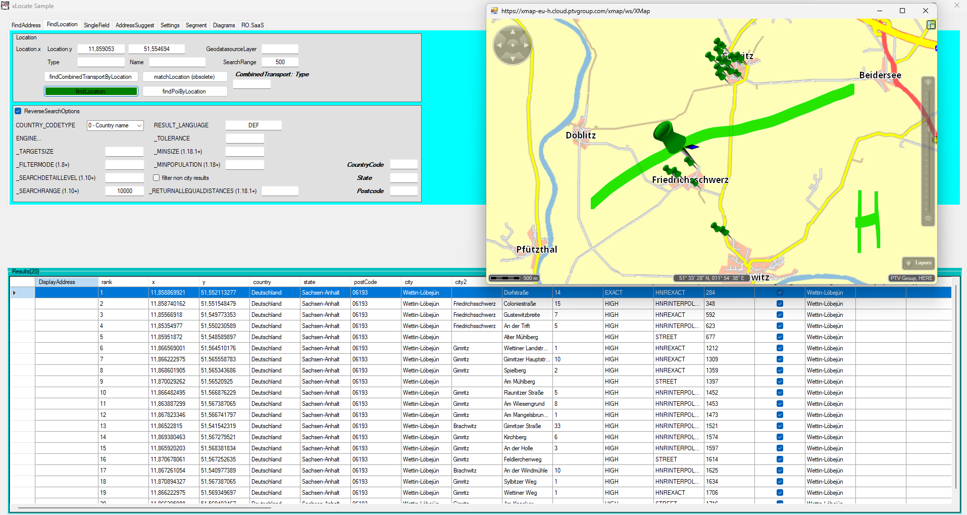

Reverse Geocoding on HERE - as the A143 is not part of the data at all it is also not considered in the reverse geocoding. The closest hit is the village near by.
