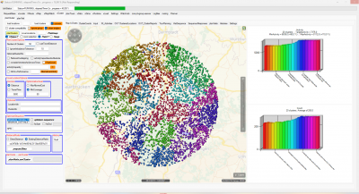

Approach #1 : native strategy
  • Simply call planClusters with the elemental locations, their coords and activities and groups
  • Advantage: simple business logic
  • Disadvantage: performance, system requirements (e.g. memory consumption when Distance matrix is used)

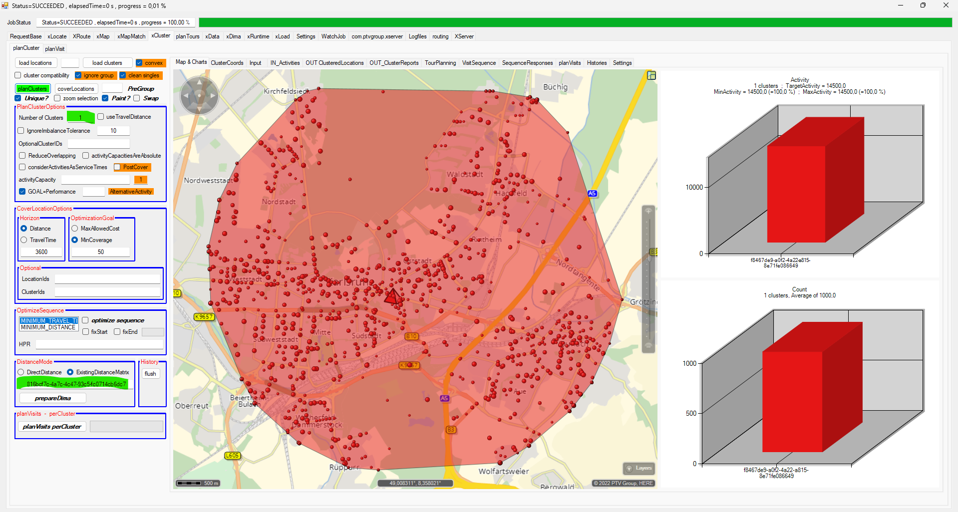

Approach #2b : preaggregate and cluster
  • Almost equal as #2a. Just perform a planClusters with each GROUP and the output cluster count = 1! This will give you an aggregated activity that represents the group and also the cluster center (chosen from the coordinates of the groupos locatios!) lies in a meaningful route location that is later used for the overall clustering ;-)
    "One cluster" outpout : the pyramid is lated used as the representing route location of the group - in this case with an aggregated activity of 14'500
