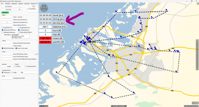

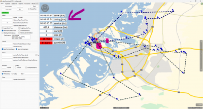

And here's an example:
- AvoidIntersections == FALSE , some intersections occur.
- AvoidIntersections == TRUE , no intersections
Though the geographic situations are getting better the number of trips increases from 3 to 4 by requesting "AVOID_INTERSECTIONS"
