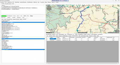

The Data API offers the possibility to search for available combined transports, try this sample:
https://developer.myptv.com/en/document ... transports
Here's an excerpt when searching for "Rola":
      "polyline": "{\"type\":\"LineString\",\"coordinates\":[[...]]}",
      "name": "Rola Wörgl-Brenner", "duration": 18082, "type": "RAIL",
      "start": {
        "latitude": 47.482539082, "longitude": 12.033915862, "name": "Wörgl", "countryCode": "AT"
      "destination": {
        "latitude": 46.103613833, "longitude": 11.096358212, "name": "Trento", "countryCode": "IT"
      "allowedFor": "VAN,TRUCK",
      "waypointsParameter": "combinedTransport=47.482539082,12.033915862,46.103613833,11.096358212"

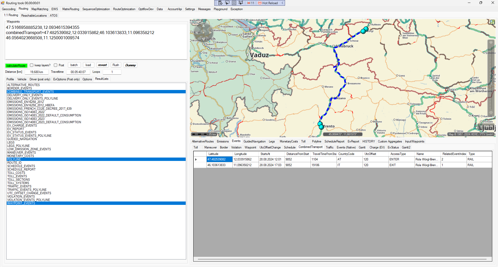

If you find the connection you desire you can use them as a combined transport waypoint in the Routing API where you specify the start and destination coordinates of the combined transport.
The response even contains the string how it needs to be specified as query parameter in the Routing API:

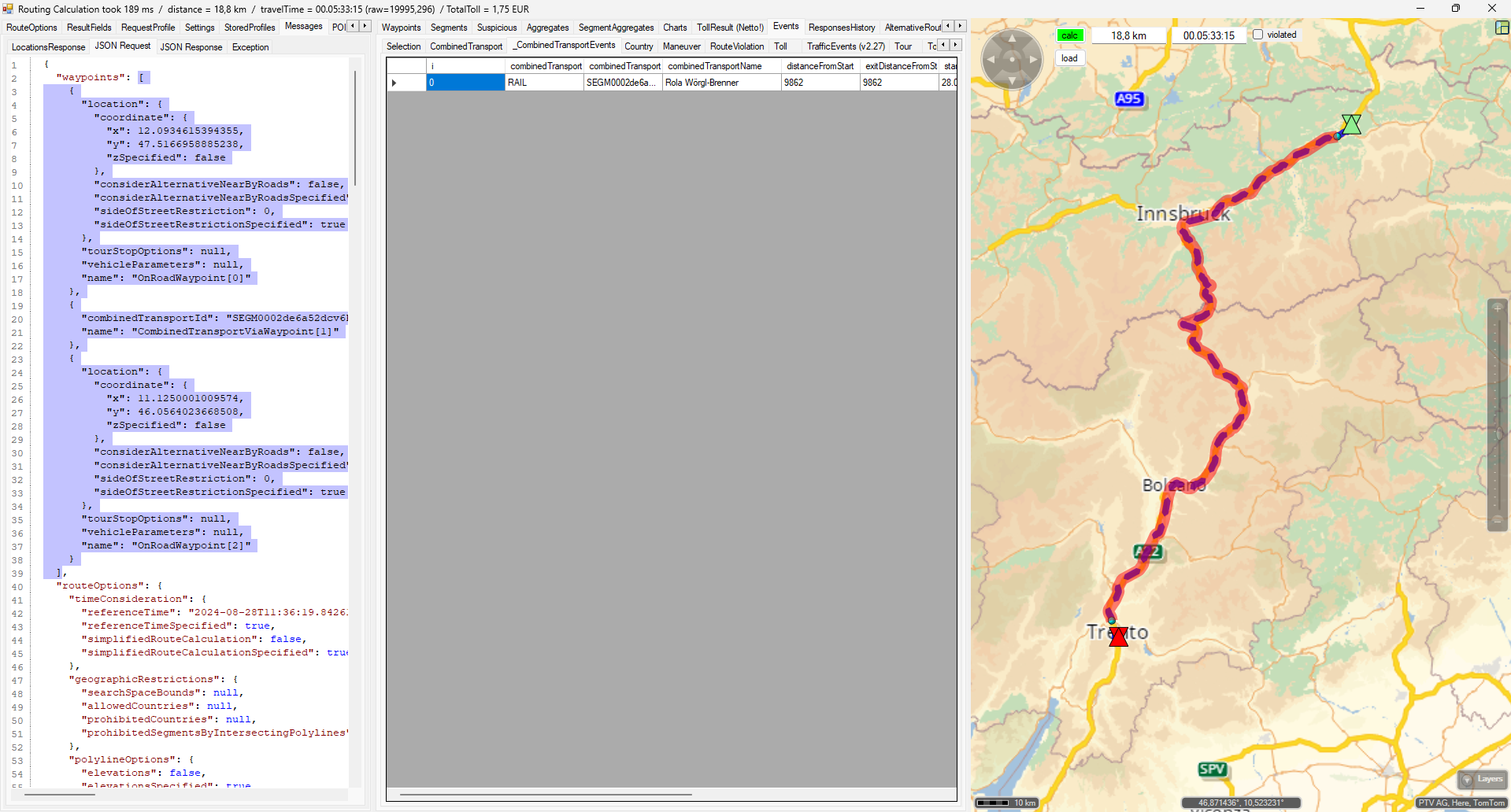

Sample "Waypoints"
      "location": {
        "coordinate": {"x": 12.0934615394355,          "y": 47.5166958885238}
      },      "name": "OnRoadWaypoint[0]"
      "combinedTransportId": "SEGM0002...[..]",
      "name": "CombinedTransportViaWaypoint[1]"
      "location": {
        "coordinate": {"x": 11.1250001009574,          "y": 46.0564023668508}
      },      "name": "OnRoadWaypoint[2]"
  "waypoints": [
    "47.5166958885238,12.0934615394355",
    "combinedTransport=47.482539082,12.033915862,46.103613833,11.096358212",
    "46.0564023668508,11.1250001009574"
