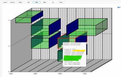

I've just been asked whether the timeslots have to be multiplied for the customers / locations in the same way as we did it with the vehicles..
The answer is : "nope - for the locations you can simply define an array of timeslots."
And even better: you can define additional properties per timeslot:
  • maximumAppointments : Describes how many appointments may be assigned to this time slot. When omitted, an unlimited number of appointments may be assigned to this time slot. (use this to manage the ramp's capacity in terms of "number of vehicles that can be served at the same time(slot))
  • costPerAppointment : Describes the cost for assigning an appointment to this time slot. (use this to define "preferences")
  • preparationDuration : Describes how long (seconds) it takes before the first task can be executed after starting the appointment.
    This chart shows the timeslots of several locations (one line per location). I decided to give a timeslot a red border if one of these additional attributes is set.
