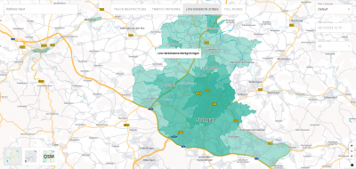

the PTV Developer Vector Maps enables users to determine the attributes of a Low Emission Zone via click in a map (Showcase):
  • https://developer-applications.myptv.com/Showcases/MapAndGeocoding/MapWithSuggestions/
Is this approach of gathering feature layer data from the underlying PTV_LowEmissionZones layer also available in PTV Raster Maps? If so - can I get an example?
