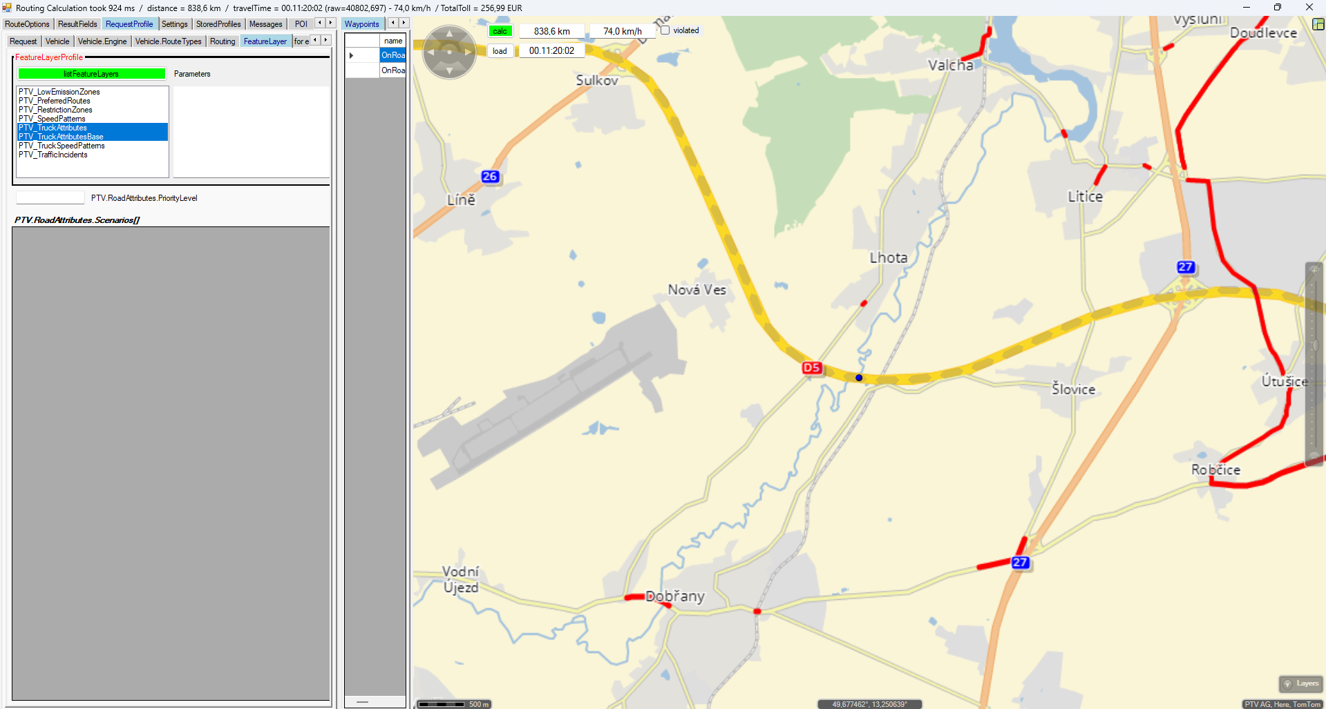

Please provide the complete request. I tried it with your coordinates and some "usual" parameters and for me the route looks valid:

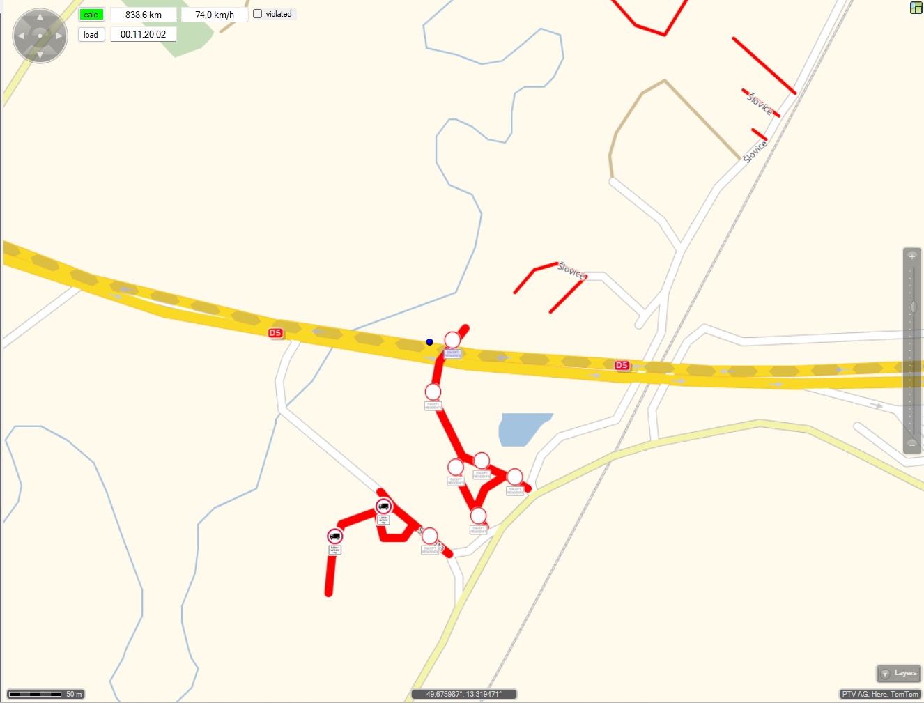

The rough approach in xRoute2 when it xcomes to com.ptvgroup.xserver.xroute.ManipulateRouteWaypoint is (based on a waypointlist A-->B(1000)-->C):
  • calculate a route from A to B based on linking B to a list of candidate segments in a close range (not automatically the closest one)
  • Walk back on the sub route for a distance of 1000m (that's the given radius) and identify a virtual stop B*
  • Then create a 2nd subroute B* --> C
  • FInally assemble to effective route A-->B*-->C
There are several residents only, delivery only and further restricted segments in the area of the manipulateWaypoint
