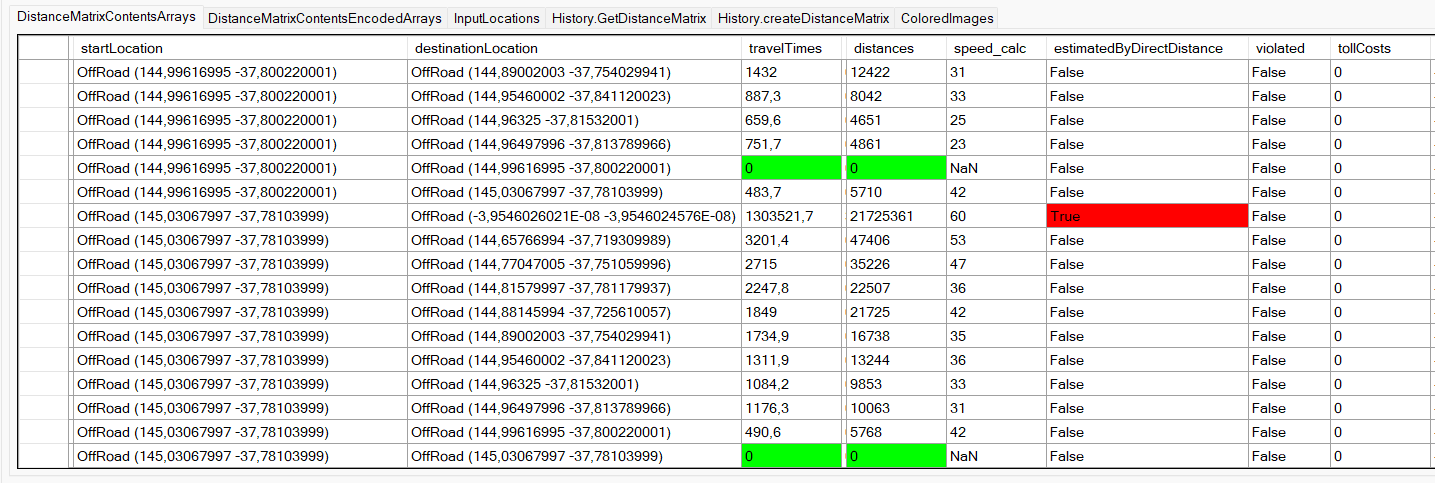

Hi Ignacio,
a distance matrix can be seen as a storage of some KPIs of undeerlying AB-routes with equal routing options:
  • The primary key of the storage is the combination of the route locations of start and destination.
  • The stored data contains
    • traveltime
    • distance
    • violation state
    • direct distance state
    • toll (optional)
    Each row represents a relation and contains data about travelTimes, distance, estimatedByDirectDistance and violated.
  • It does NOT contain details such as
    • Cause of a violation
    • Event lists
    • Toll details
That being said a tour optimization algorithm needs to read from a dima multiple (often millions of) times to assemble temporary structures which are then evaluated:
  • What is the complete time scheme? Does it violate opening times or operating times?
  • What distances apply? Does a vehicle's tour exceed maximum values?
  • With the routing there's also the option to define some "flexibility" when it comes to "are violations allowed"?
    • ignoreRouteViolations
    • ignoreReachabilityViolations
    So if you enforce newly built tours to be "clean" (without violations) then some locations which can't be reached without violations will remain unscheduled (orders flagged as unplannable)
What you should also consider is the potential combinations of the relation properties "violated" and "estimatedByDirectDistance" as not every combination can occur:
violatedestimatedByDirectDistancedescription, possible?
falsefalsebest routing based "condition"
truefalserouting based but kind of "suspicious"
falsetruesuccessful routing wasn't possible (e.g. because violations have been disabled), therefore workaround based on airline applies
truetrueimpossible
