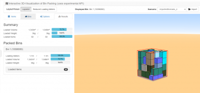

This is a result of dummy data of a single bin planning:
The prospect then asked me, whether the output could focus on a lower tower height instead of reducing the floor's coverage.
Original bin height: 210cm.

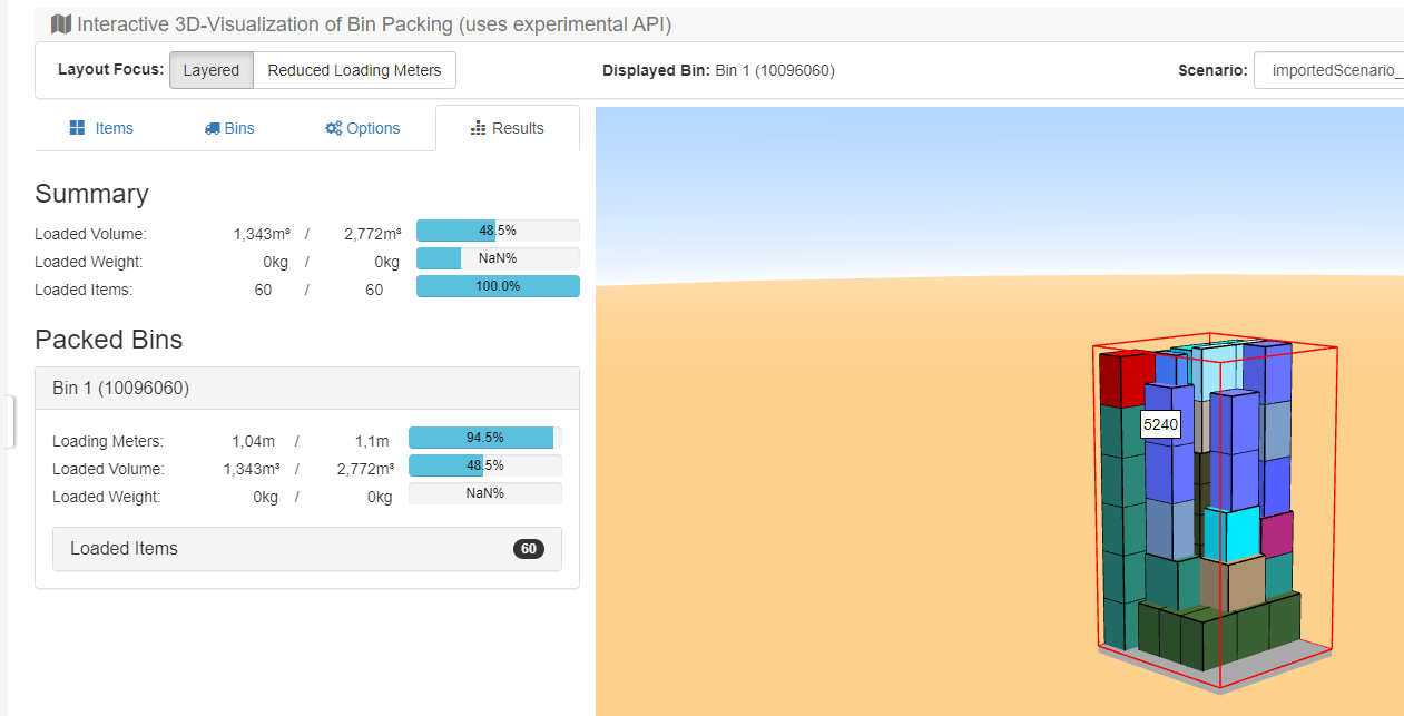

Well, there's no built in target function or parameter for this, but what I applied in the next images was simply reducing the bin's given height: by adapting this value I managed to create an output that matches the prospects goal:
140cm instead of 210cm leads to "no unplanned items, total tower height reduced"

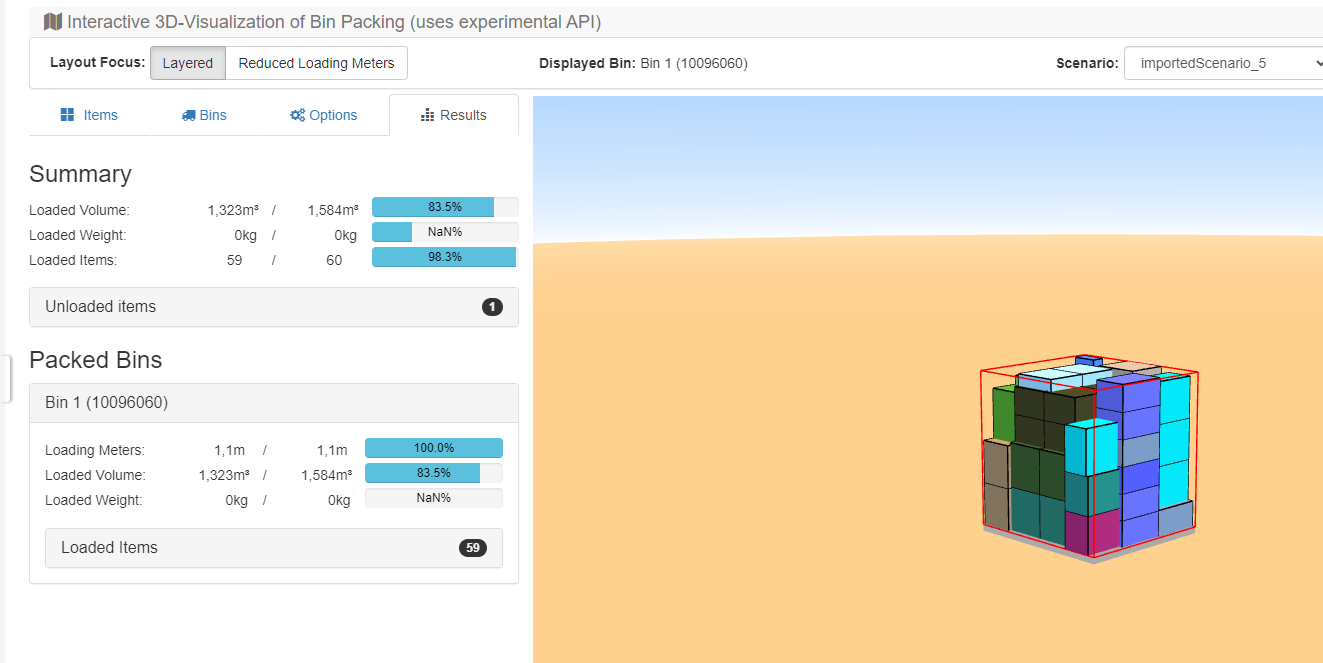

With a 120cm height of the bin a first item remains unplanned.
