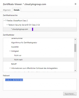

PS: Besides SAP I know that there's a trust chain that is escalating through a set of certificates if the initial one is not valid... here are some examples:
PTV xServer Internet Certificate - expires in 2025

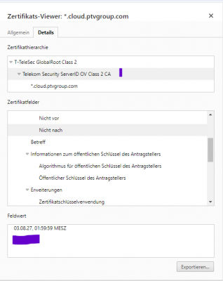

intermediate certificate - expires 2027

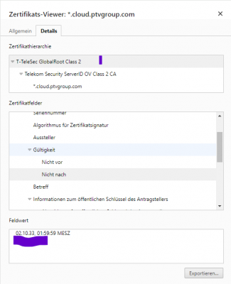

root certificate as last resort - expires in 2033
