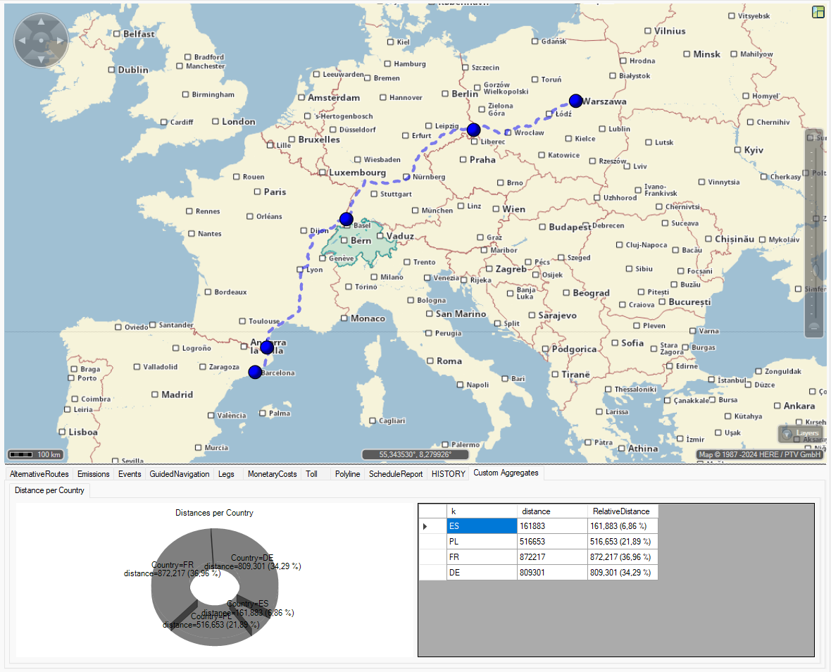

I've been asked how I'd recommend to compute the "distance per country" in a PTV Developer Routing API client application (as this info is not native part of the response).
Here's my approach - based on Border_Events and Waypoint_Events.
Feedback is welcome - especially if you detect an error ;-)
