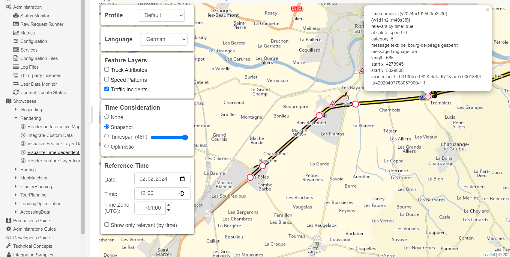

some roads where temporary blocked by striking farmers.
Comparing the routes, suggested by PTV on our system, with the route on PTV's online tool, we see that we're getting the suggestion to go through the blocked road, while PTV's online tool suggests going around the blockings:
1) Route by PTV that we're getting: https://prnt.sc/cYH2SpkUGTSw
2) route suggested on TVS's online tool: https://prnt.sc/32s0jIb89xNP
ALSO, when zoomed in:
https://prnt.sc/uVs3htuHm99U

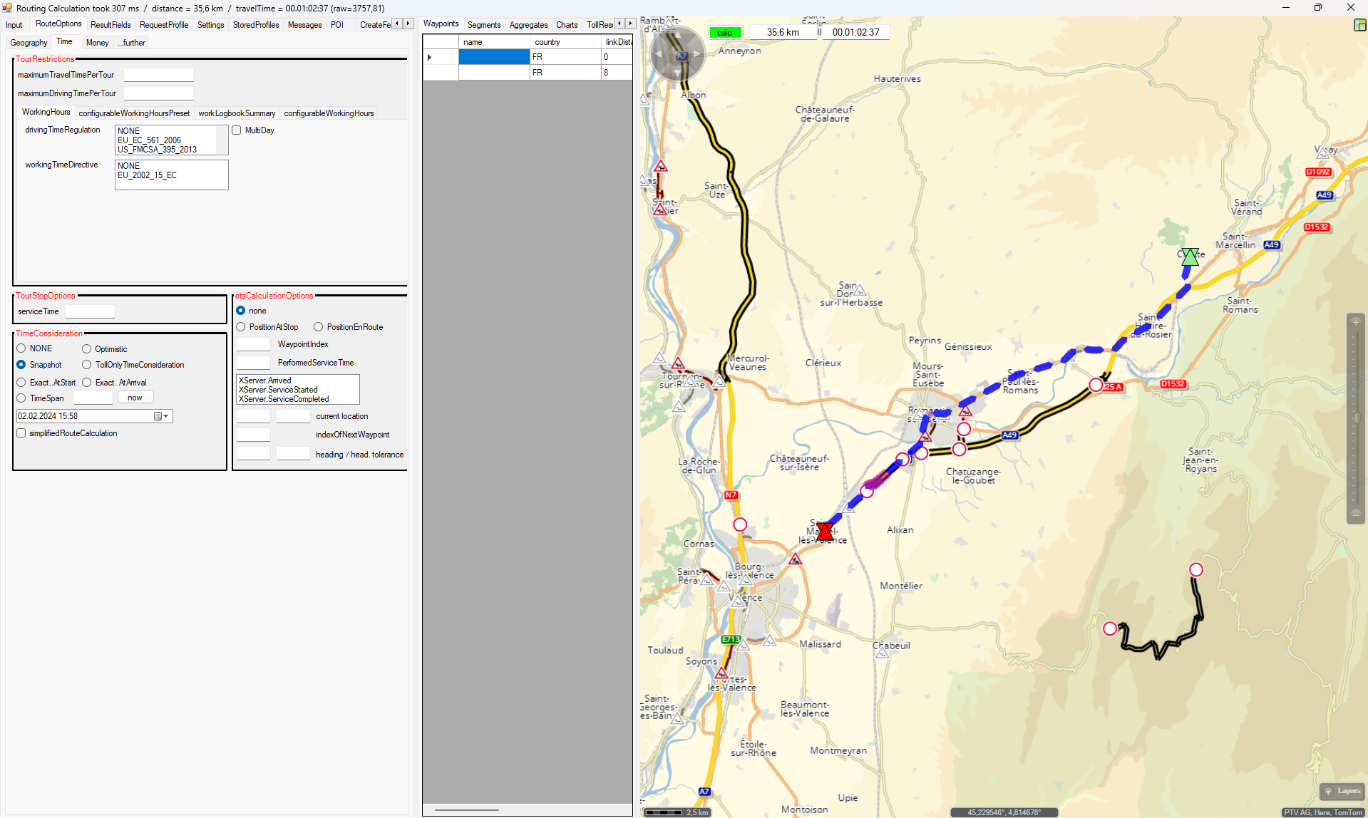

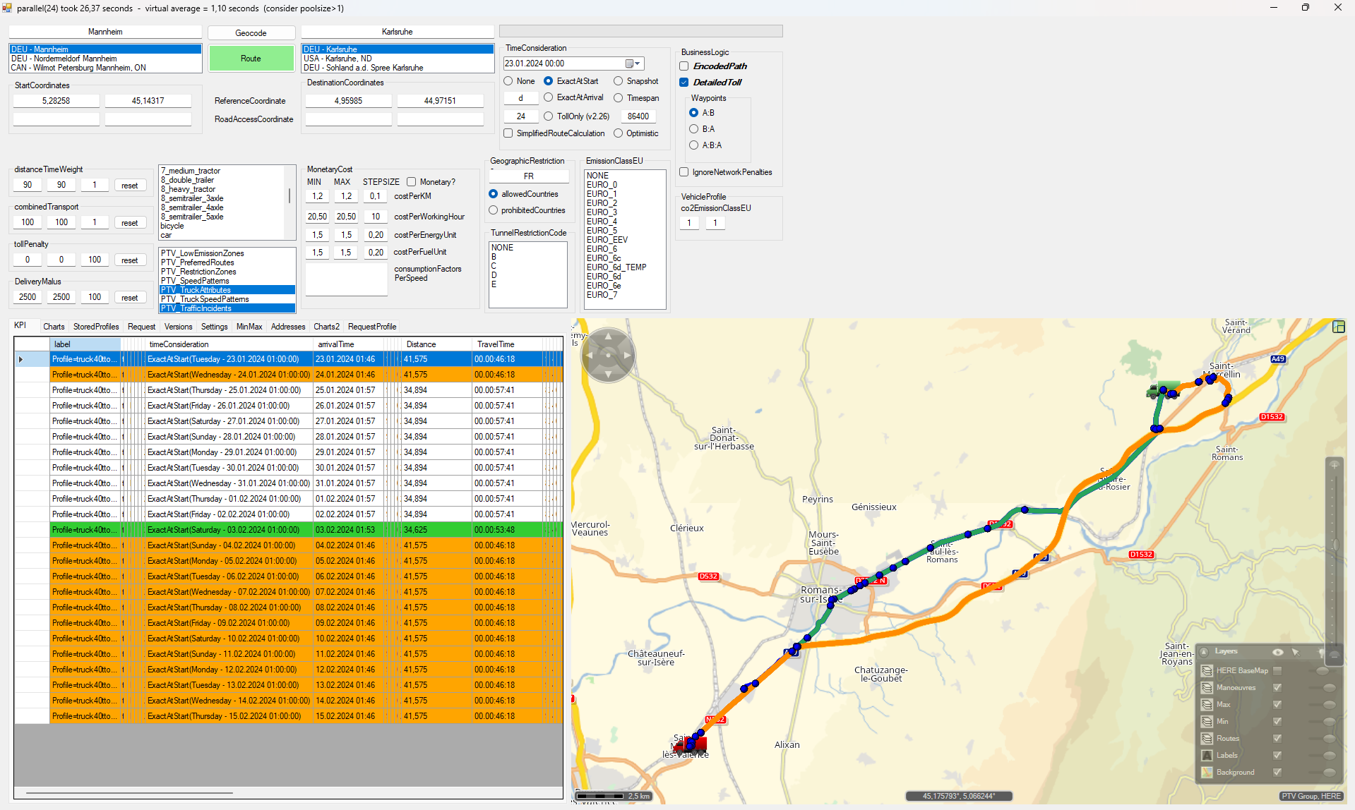

Re: Route with/out taking into account the temporary farmer road blockage
what time consideration mode did you activate?
Provide your request and I'll check it...

Thank you, this helped:
"timeConsideration":{
"$type":"ExactTimeConsiderationAtStart"
