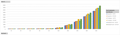

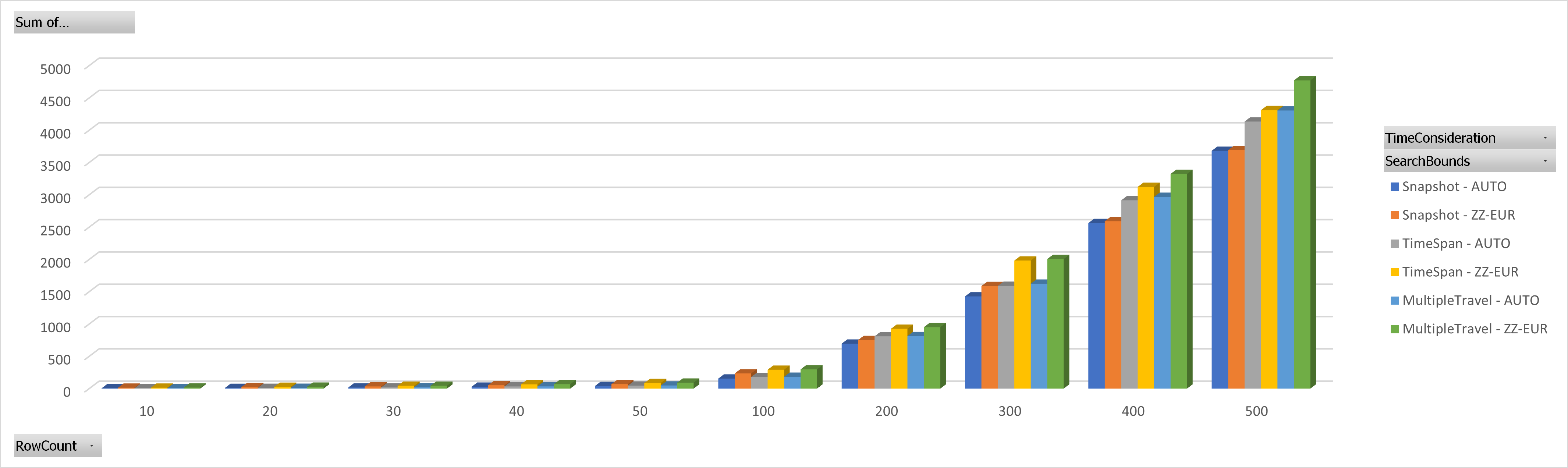

Wow, here comes a hardcore test result
I computed CONVENTIONAL matrices of various sizes based on some thousand German zip codes. Times in seconds...
Request based on
  • StoredProfile = "car"
  • GeographicRestrictions : allowedCountries : ["ZZ-EUR"]
  • FeatureLayerThemes: ["PTV_TruckAttributes", "PTV_SpeedPatterns"]
RowcountSnapshotTimeSpanMultipleTravelTimes
1014,2 / 0.00:00:1414,216,4
2022,7 / 0.00:00:2328,328,6
3032,9 / 0.00:00:3344,343,7
4052,3 / 0.00:00:5266,168,3
5069,1 / 0.00:01:0986,391,8
100235 / 0.00:03:55292297
200752 / 0.00:12:32926951
3001588 / 0.00:26:2819802005
4002591 / 0.00:43:xx31223323
5003692 / 0.01:01:3243114771
100011070 / 0.03:03:301286414475
200074797 / 0.20:46:xx
TimeConsideration-Matrices.xlsx
Test results based on my notebook
(27.2 KiB) Downloaded 2582 times
comparison of sizes versus calculation times based on different search bounds and time calculation modes
