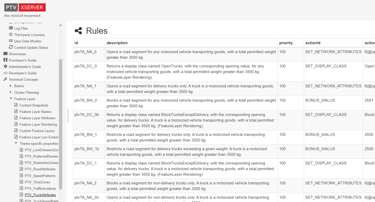

Today a colleague asked me for a sample request that demonstrates how to activate a rule as mentioned in PTV_TruckAttributes.Rules:
Here's a ridiculous example - depending on the swith in line 15 the truck attributes consideration is disabled but only within Germany and Luxemburg:
Depending on the boolean parameter in line 15 the TruckAttributes are ignored or not
