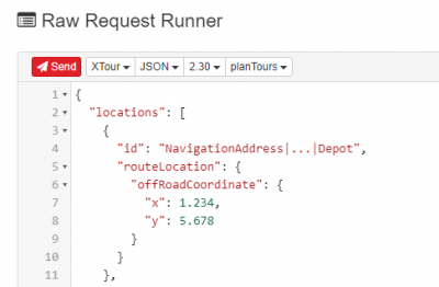

every once in a while a player sends a request message to us (support, consulting) for a reproduction of a case. More and more often we encounter a "we can't reproduce the request in the raw request runner without applying some manual changes...". Here is an example:
"message": "Cannot construct instance of `com.ptvgroup.xserver.xtour.Location` (no Creators, like default constructor, exist): abstract types either need to be mapped to concrete types, have custom deserializer, or contain additional type information\n at [Source: (org.apache.cxf.transport.http.AbstractHTTPDestination$1); line: 38180, column: 1] (through reference chain: com.ptvgroup.xserver.xtour.PlanToursRequest[\"locations\"]->java.util.ArrayList[0])",
"errorLine": 38180,
"errorColumn": 1,
"faultType": "com.ptvgroup.xserver.exceptions.InvalidRequestFault"
- The engine needs t know whether this location is a DepotSite or a CustomerSite.
Please ensure to provide requests / responses in a proper, complete way.
JSON is state of the art. XML/SOAP is also possible but not the first choice...
Maybe you have to check the settings of the serializer / deserializer you use.
