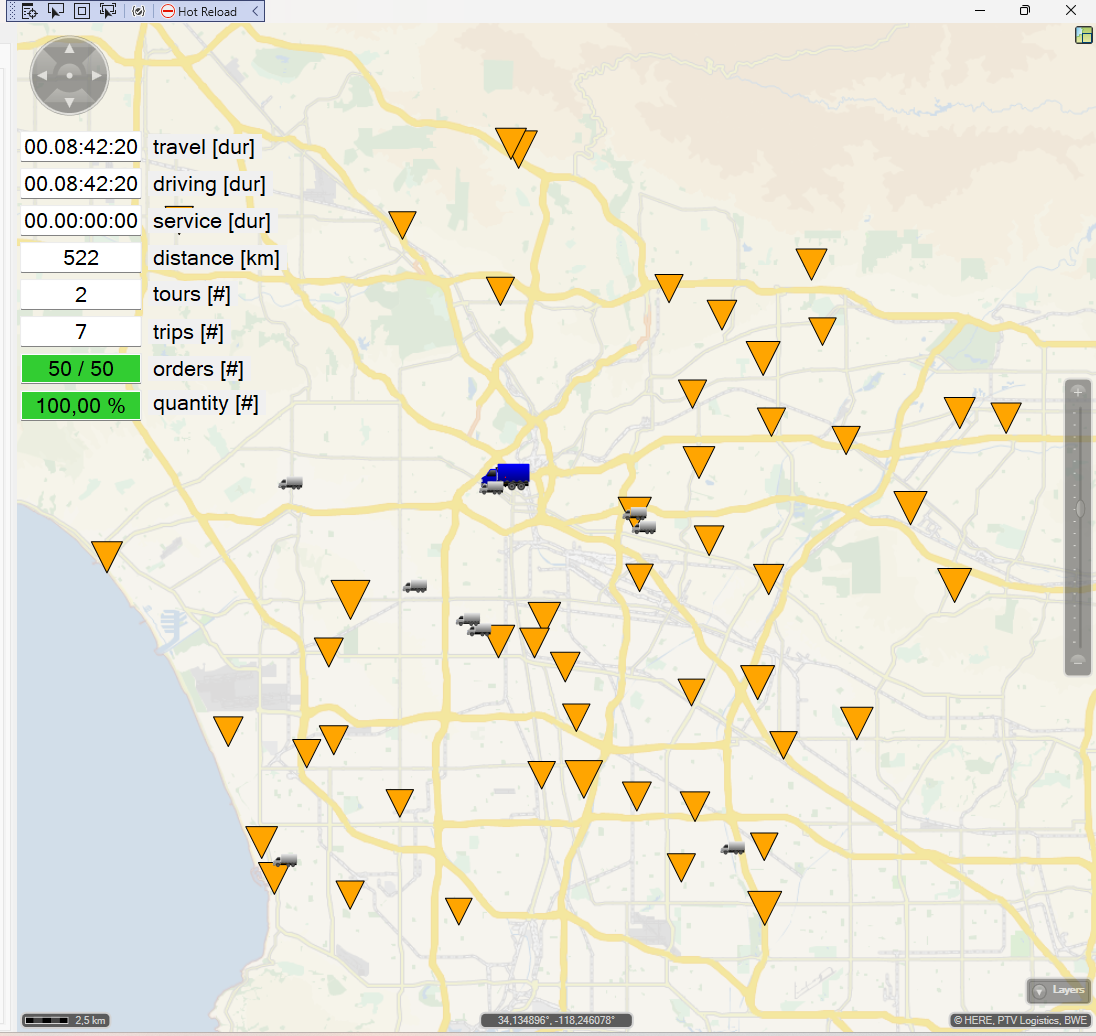

I've been asked for the following requirement and whether / how to modell this in xTour2:
Generic setup:<br />blue truck - central depot <br />gray trucks: small refill stations
Generic setup:

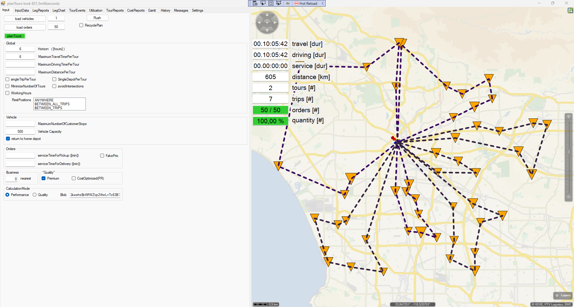

  • Scenario 1 : no utilization of the gray locations
    #1 refill at the central depot

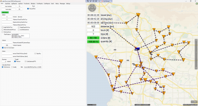

  • Scenario 2 : refill on the road based on "from scratch" planning
    Scenario #2: Refill on the road from scratch (no input plan used)

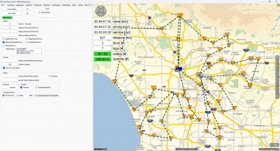

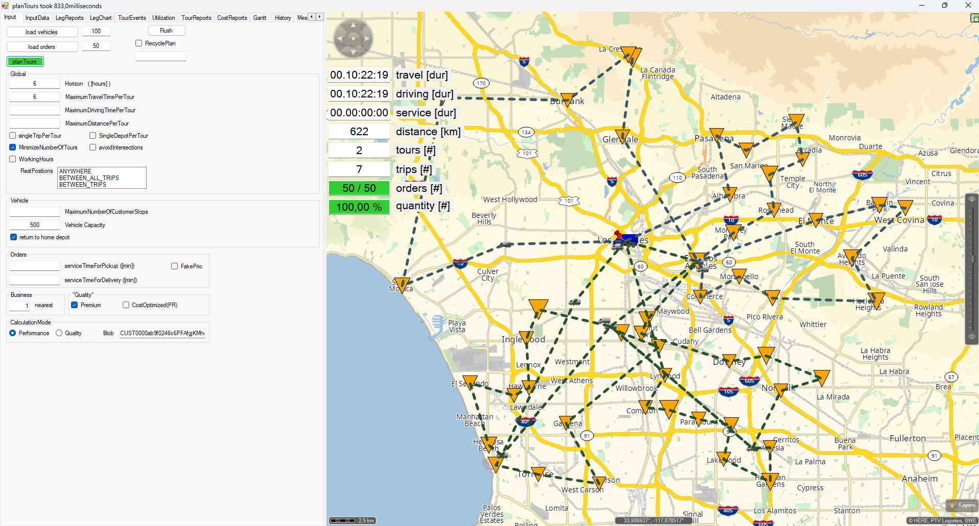

  • Scenario 3 : the gray locations are used for refilling "on the road"
    Scenario 3a: From the nearest depot

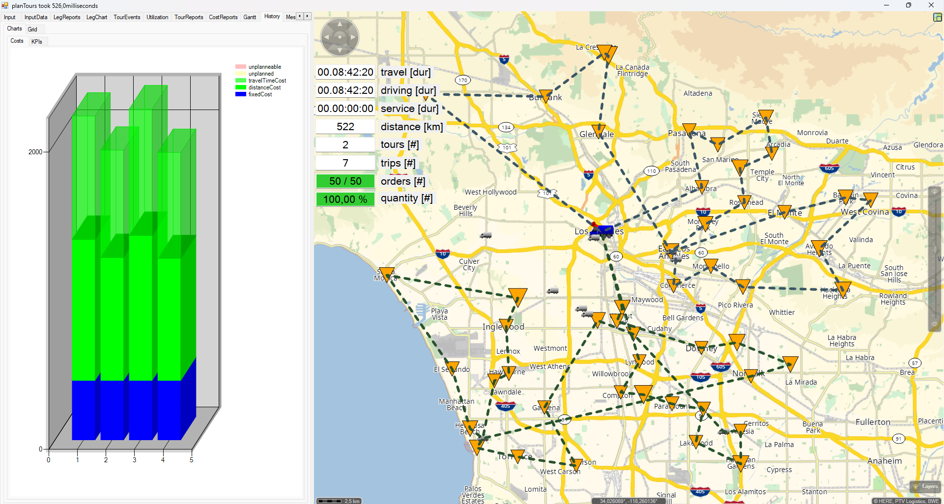

    #3b: refill on the road (graytrucks are the refill stations)

Scenario 3 was built on a small iteration:
  • I created an initial solution based on "each order has to be served by the closest depot" (scenario #2)
  • Then I used the output plan as input plan for a planning with AlternativePickup and allowed each available location as refill location
