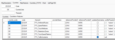

That's in fact a tricky one. I recommend that you look into the
com.ptvgroup.xserver.xruntime.DataInformationRequest which enables you to drill through the available data of a system, also on prod:
In the
com.ptvgroup.xserver.xruntime.DataInformationResponse you can iterate through
- Test Frontend which enables me to idenify data coverage in regions...
- All FeatureLayerThemes within DE...

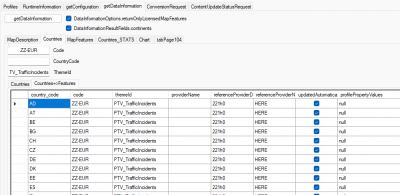

Related to my question in the forum, I understand your answer, that we could find the list of countries using API.
I was thinking more about some document or web page that listed all countries for which Traffic Incidents and Detailed tolls are provided for now - Like one I found from TomTom (I hope that I find an appropriate page?)
https://developer.tomtom.com/intermedia ... t-coverage
I saw on TomTom that Montenegro is not provided. If I am not wrong, I could check that on the link provided previously? But, what about Serbia, Bosnia and Herzegovina? I see them listed on TomTom, but don't see them listed in our xServer 2 after data from CUS are received as you can see in the image in the attachment.
Are there any other providers besides TomTom that xServer (or CUS) can use?
