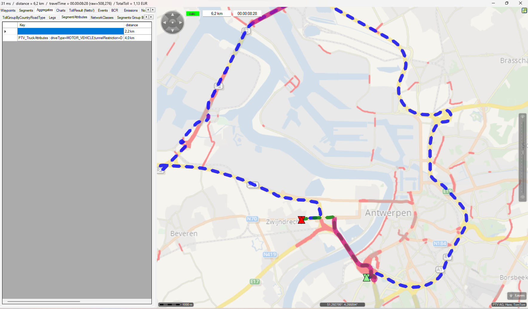

from a theoretical perspective my feedback about that story is:
green route: Vehicle with TunnelCode=E<br />blue route: vehicle with TunnelCode=D<br />southern pink segments: 4km tunnel segments with codeD
PS: it 's probably easier to respond if the specific request / response of the customer is given. Here's an example... 40T truck...
