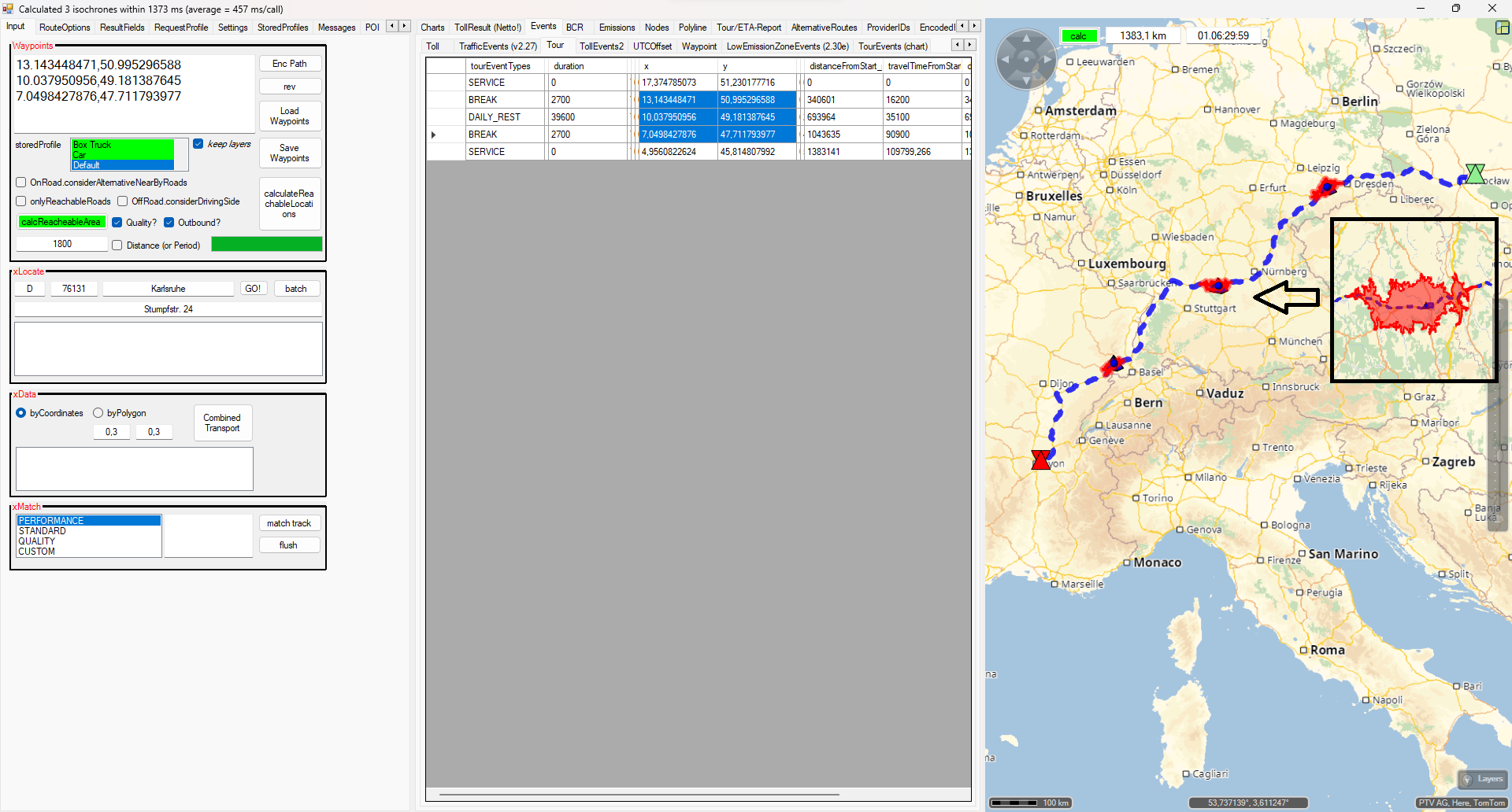

Well - obviously a reconfiguration isn't an option in PTV xServer Internet. But how about this:
  • Imagine you want to drive a >1000km route from Poland (Wroclaw) to France (Lyon)
  • You need to have a rest in a radius within 30minutes along the route corridor. Unfortunatel the corridor calculation runs into the error described above.
  • Here's the work around: Now you can use the break- and rest rules to determine the proper TourEvents along the route.
  • Then use a calculateReachableArea for each TourEvent with a horizon of 30mins
  • Instead of searching in one large corridor the quality of the output is even better because there will be some proper "distance" between the breaks
