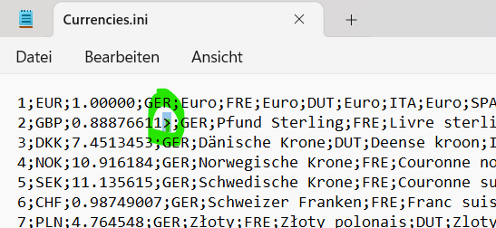

One of our partners recently reported to have ran into this error message in an xRoute1 environment (2023.2H map) while he was dealing with routings to/from/through the United Kingdom and requested toll:
Here's what this is about:
In his case there was an error in the file Currencies.ini in the map. In the entry for GBP there is a wrong character ">" behind the exchange rate. Please remove the character and restart the server.
This should work fine then... If not: create a helpdesk ticket

</ns6:stackElement></ns3:XRouteException></detail>In his case there was an error in the file Currencies.ini in the map. In the entry for GBP there is a wrong character ">" behind the exchange rate. Please remove the character and restart the server.
