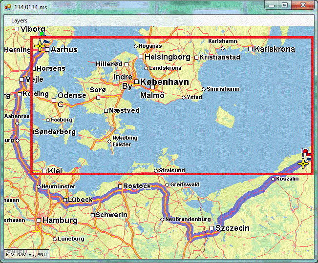

Hello together,
these days a customer asked me about some strange behaviour within a simple tour planning call: though he requested ROAD based computation of driving time and distance the engine obviously returned geometric values.
This effect is caused by a configuration parameter (dima ini-file) that is called SectionBuffer. The default value is 20000 (meters). This buffer defines an area around the given coordinates: streets outside this area will not be considered. If the routing isn't possible within this area the server processes a fallback to geometric.
Well, why does this happen in the given case? Simply because the destination (red flag) is somehow isolated ;-)
If this occurs in your environment you should check whether disabling the section buffering (SectionBuffer-1) prevents you from this effect. It helped me in the given example.
Regards from Germany,
Destination is isolated because of the buffer area
