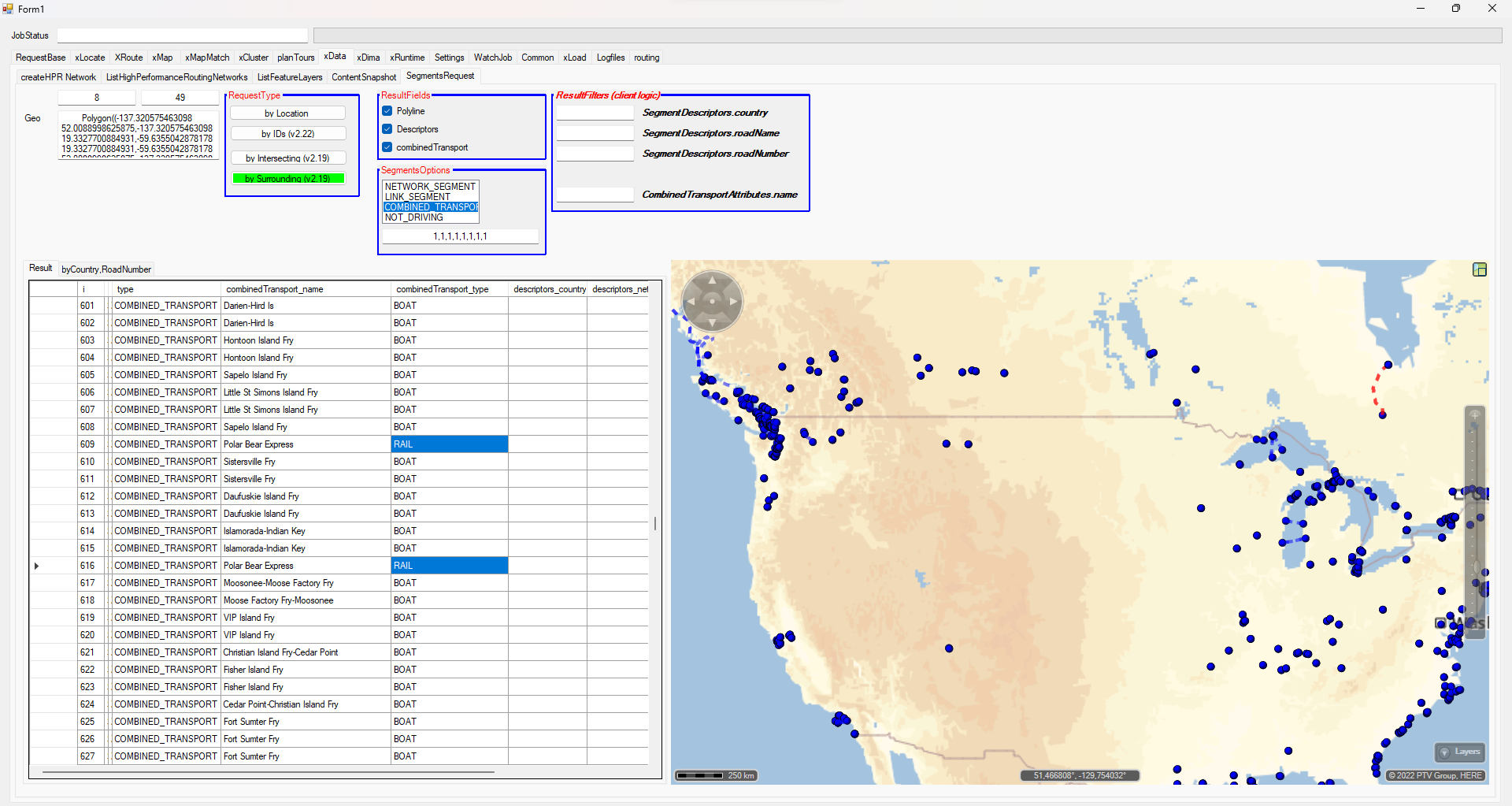

depending on the specific usecase and the APIs you are supposed to use I could imagine several approaches:
  • Within xData2.SegmentsBySurroundingPolygonRequest you can locate all segments of a specific SegmentType (COMBINED_TRANSPORT) within a given rectangle. You may have to filter the result for BOAT.
    Disadvantage: there's no country filter available for this approach - but maybe you don't need it ;-)
    some of the response elements are RAILWAY STATIONS which you may have to filter  on client side
