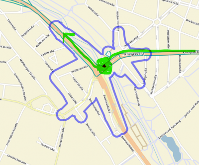

and so he needs to know when it is time to trigger this. My spontaneous approach was to calculate some geofence:
500m isochrone / area of reach around the event
