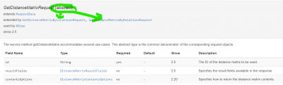

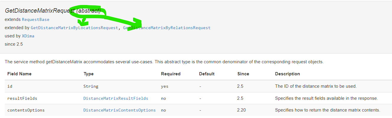

  • The xDima2.GetDistanceMatrixRequest is an abstract class which you can't instanciate.
    Taken from the API doc of GetDistanceMatrixRequest
  • Instead you have to use one of it's derived child classes - in this case either GetDistanceMatrixByLocationsRequest or GetDistanceMatrixByRelationsRequest
