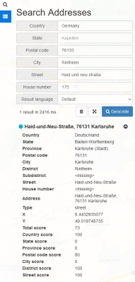

The total score is mainly used to sort the result list. This applies to both xLocate 1 as for xLocate 2. As Bernd said, the score calculation of xLocate 2 and xLocate 1 differs. There is a technical concept of how the score calculation of xLocate 2 works.
I recommend not only using the total score as criterion for wether an address has been geocoded correctly or not but also to considere the field scores.
For example, a result of a total score >= 80 could be said to be geocoded. Results of a total score < 80 don't mean that they are to bad to be considered geocoded. For these cases you could use the field scores for example you could say if the field scores for postalCode and (city or district) and street is >=80 you also considere as geocoded. See the example below:
This is just one example that you need to adapt to your use case and test well before you use it productively ;)
