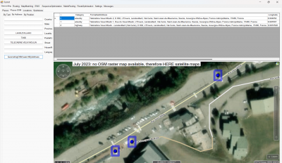

is a request for an alternative geocoder: The
PTV Developer Geocoding&Places OSM API.
Does this look promising?
- Visualization of the OSM result
"places": [
"referencePosition": {
"latitude": 45.289363,
"longitude": 6.904852
"boundingBox": {
"left": 6.904802,
"bottom": 45.289313,
"right": 6.904902,
"top": 45.289413
"formattedAddress": "Télécabine Vieux Moulin 2, D 902, L'Envers, Lanslevillard, Val-Cenis, Saint-Jean-de-Maurienne, Savoie, Auvergne-Rhône-Alpes, France métropolitaine, 73480, France",
"category": "amenity",
"type": "car_pooling"
"latitude": 45.288678,
"longitude": 6.903597
"boundingBox": {
"left": 6.903547,
"bottom": 45.288628,
"right": 6.903647,
"top": 45.288728
"formattedAddress": "Télécabine Vieux Moulin 1, Rue du Vieux Moulin, L'Envers, Lanslevillard, Val-Cenis, Saint-Jean-de-Maurienne, Savoie, Auvergne-Rhône-Alpes, France métropolitaine, 73480, France",
"latitude": 45.2885832,
"longitude": 6.9033528
"boundingBox": {
"left": 6.9033028,
"bottom": 45.2885332,
"right": 6.9034028,
"top": 45.2886332
"formattedAddress": "Télécabine Vieux Moulin - Lanslevillard (Val-Cenis), D 902, L'Envers, Lanslevillard, Val-Cenis, Saint-Jean-de-Maurienne, Savoie, Auvergne-Rhône-Alpes, France métropolitaine, 73480, France",
"category": "highway",
"type": "bus_stop"
