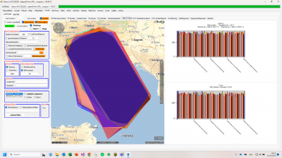

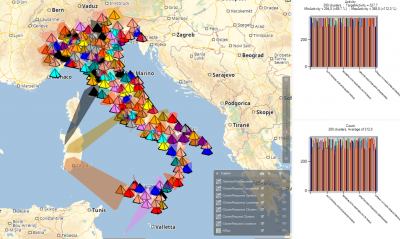

as you know I am often evaluating the performance of our components with bigger planning scenarios.
I've been asked for some
I made some samples and what I learned from this is that the underlying default settings for then com.ptvgroup.xserver.clusterplanningprofile.ClusterPlanningProfile.SolverTimeLimit is set to an insufficient 300secs = 5minutes. After increasing the value to 900secs=15min the responses looked way better...
So for those who want to apply larger scenarios we recommend to look into the SolverTimeLimit to ensure the algorithm has enough time to play.
