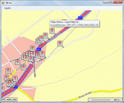

the testclient XRouteToll used for the xRoute access supports both
  • traditional mapping
  • xServer.NET based mapping
Unfortunately my implementation of the second approch doesn't support visualization of TruckAttributes, this is why you can't see them on the map (though they appear in the segment attributes list): DIR_OPT_COND_MALUS5|0=35....
Not an engine error but a lack of the test client... but: works fine with the approach 1 (traditional mapping)
I found an old piece of documentation that describes that this malus value is interpreted as follows:
  • The segment has a condition: 35.
    The vehicle has a corresponding value.
    If the value of the vehicle exceeds the segments value, the malus is applied on the segment.
  • But: neither the profile nor the request does not mention the vehicles explicit value. I assume the default vehicle value is 0. Which means: no need to apply the malus: use the segment.
  • By parametrizing the vehicles value with DIR_OPT_COND_MALUS5=2500;666 we exceed the segments value, the malus is applied and we take the detour. That's it...
